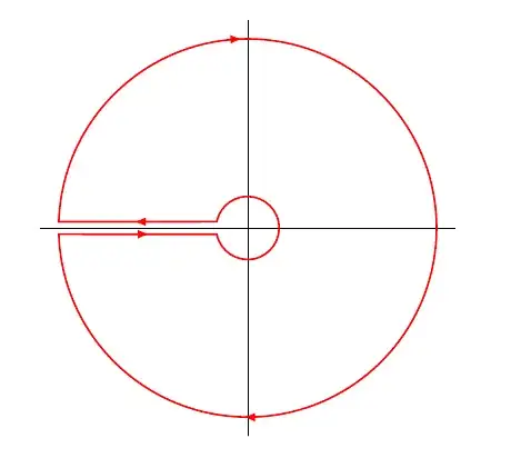

Let $$f(\delta,x) = \frac{(\ln x)^2}{(x-i\delta)^2-1},\ \delta>0.$$ Integrate $f(\epsilon,x)$ over the contour $C$
keyhole contour
It can be shown by comparing the magnitude of functions on the larger circle with radius $R$ and on the smaller circle with radius $\epsilon$ that as $R\to\infty$ and $\epsilon\to0^+$ the contour integral approaches
\begin{align} \frac{\pi^2}2 + o(\delta)&=\text{Res}\big(f(\delta,\cdot),-1\big) \\ &=-\frac1{i2\pi}\oint_Cf(\delta,x)dx \\ &= -\frac1{i2\pi}\int_0^\infty \left(\frac{(\ln x+i\pi)^2}{(x-i\delta)^2-1}-\frac{(\ln x-i\pi)^2}{(x-i\delta)^2-1}\right)\,\mathrm dx \\ &= -2\int_0^\infty\frac{\ln x}{(x-i\delta)^2-1}dx. \\ \end{align} So $$\int_0^\infty f(\delta,x)dx \to-\frac{\pi^2}4$$ as $\delta\to0^+$.

Since $\displaystyle\frac{\partial x^u}{\partial u}=x^u\ln x,$ let $$f(u,\delta,x) = \frac{x^u}{(x-i\delta)^2-1},\ u\in[0,1),\,\delta>0.$$ Integrate $f(\epsilon,x)$ over the contour $C$
keyhole contour
It can be shown by comparing the magnitude of functions of the radii $R$ and $\epsilon$ that as $R\to\infty$ and $\epsilon\to0^+$ the contour integral approaches \begin{align} \frac{1-e^{i\pi u}}2 &= \text{Res}\big(f(u,\delta,\cdot)\big) \\ &= -\frac1{2\pi i}\oint_C f(u,\delta,z) dz \\ &= -\frac{e^{i\pi u}-e^{-i\pi u}}{2\pi i} \int_0^\infty f(u,\delta,x)dx \end{align} $$\int_0^\infty \frac{\ln x}{x^2-1}dx = \lim_{\delta\to0^+}\frac{\partial}{\partial u}\int_0^\infty f(u,\delta,x)dx \bigg|_{u=0} = \frac{\pi^2}4.$$
