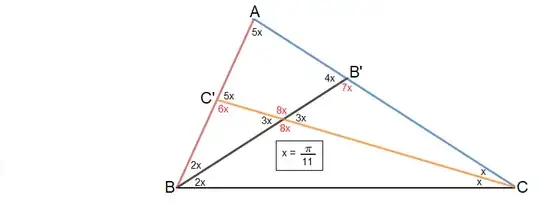

COMMENT.- This is not properly a hint but a (nice) remark that I can not avoid mentioning. Given the value $x=\dfrac{\pi}{11}$ there are triangles $\triangle{ABC}$ like that of the attached figure intimately linked for which there must be a counterpart of the proposed problem in angles with the sides and bisectors $BB'$and $CC'$ of the triangle (in particular $\triangle{ACC'}$ is isosceles and $\triangle{ABB'}\sim \triangle{ABC}$).
One has all the five angles, $x,2x,3x,4x,5x$ of the problem in $\triangle{ABC}$ because of $5x+4x+2x=\pi$.
