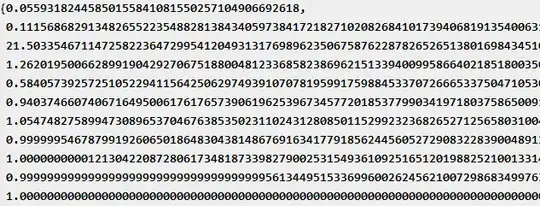

If you have some starting point $x_0$, you could obtain $x_1$ by $$x_n=x_{n-1}-\frac{f'(x_{n-1})}{f''(x_{n-1})}$$ and after that use $$x_n=x_{n-1}-\alpha\frac{f'(x_{n-1})}{f''(x_{n-1})}$$ where $\alpha$ solves $$x_{n-1}-\alpha\frac{f'(x_{n-1})}{f''(x_{n-1})}=x_{n-2}-\alpha\frac{f'(x_{n-2})}{f''(x_{n-2})}$$ For the following function with many $0$-valued derivatives at the minimum $x=1$,
$f(x)=4 (1-x)^8+4 (1-x)^{12}+1888 (1-x)^{14}+1888 (1-x)^{22}$
when starting at $x_0 = 0$ the 3rd iteration overshoots big time, but sufficiently close to the minimum the quadratic convergence begins (see bottom picture, it actually looks super-quadratic) despite 6 derivatives being equal to $0$.
In the case where all derivatives are 0 at the minimum the modification doesn't make the convergence quadratic. I haven't found something that really works in that case.
In higher dimension, where $x_n$ and the fraction are vectors, you can solve the same alpha equation for each parameter, or just those that cause slow convergence.
