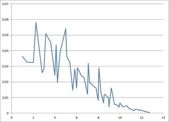

Below is a graph showing the probability distribution for $L=10$

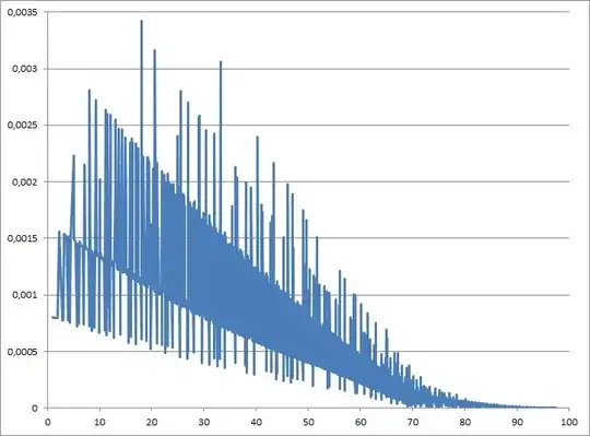

And here is the distribution for $L=40$
There seems to be an asymptotic nature to this.

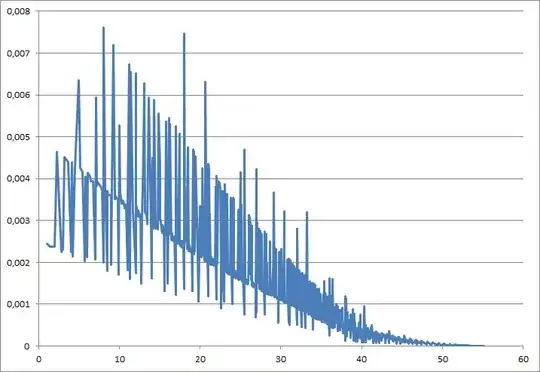

The above is for $L=70$. The extra large spikes occur where a distance can be generated in more than one way.
