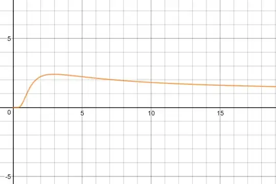

To answer your other question as to why the sequence seems to increase. The plot of $a_n$ vs. $n$ looks like this enter image description here
You can see that it initially increases but decreases past $n = 3$. In fact, it decreases very slowly to $1$:
$$ a_{10} = 1.813619 $$ $$ a_{100} = 1.135779 $$ $$ a_{1000} = 1.019820 $$ $$ a_{10000} = 1.002657 $$

  • i can show it tends to 1 but the problem is if i input n=1,2,3...etc the sequence gets bigger and bigger so how does it tend to 1 e.g. for n=1 its 1, n=2 its 2.236... n=3 its 2.5... – user504498 Nov 19 '17 at 00:15
    @user504498: if you can show that a sequence tends to $1$ then it is obvious that as the value of $n$ increases the values of sequence will start to get close to $1$. I wonder why you are getting confused with few initial values of $n$. Did you check the value of the sequence for $n=10000$? Moreover checking different values of $n$ is not the key. The limiting behavior of a sequence may be observable empirically only after $n$ exceeds a certain value. This is formalized in the $\epsilon, N$ definition of limit and if $\epsilon$ is small you may need a very large $N$. – Paramanand Singh Nov 19 '17 at 13:41
