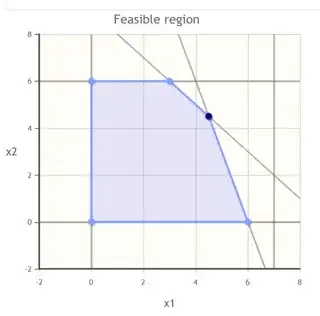

One that I use on a near-daily basis is an appspot online solver created by Gerard Sierksma and Yori Zwols for their book Linear and Integer Optimization. It functions like CPLEX, and has a cool feature for two-variable programs where it will draw the feasible region like so:
An advantage of it is that it is free and easy to save a load models from Google Drive, as the website has an option to import and export models.
