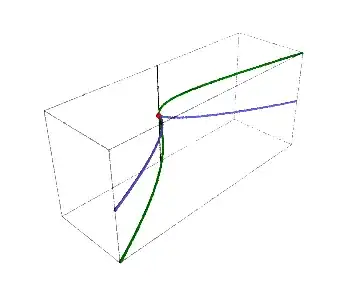

We can do the same thing in the case of the cuspidal cubic, obtaining the parametric curve $$ \wt{C} = \{(z^2 , z^3, z) : z \in \C\} $$ as shown in Zach Teitler's answer.
$\hspace{3cm}$ enter image description here
It's kind of hard to see what's going on from these still images, so it might be more illuminating to play with the interactive plots (made with SageMathCell) yourself: nodal cubic, cuspidal cubic.

Let $R' = R[y/x]$. We can think of $R \subset R' \subset \operatorname{Frac}(R)$, the field of fractions of $R$.
I claim that $R' \cong \mathbb{C}[t]$. Write $t = y/x \in R'$. In $R'$, $xt=y$, so $x^2 t^2 = y^2 = x^3$. Since $R'$ is an integral domain, $t^2 = x$. And then $t^3 = y$. So (with some hand-waving) $R' = \mathbb{C}[x,y,t]/(y^2-x^3) \cong \mathbb{C}[x,y,t]/(t^2-x,t^3-y) \cong \mathbb{C}[t]$.
If you are familiar with prime spectra of rings, the inclusion $R \subset R'$ gives a map $\operatorname{Spec} R' \to \operatorname{Spec} R$.
If you would rather work with affine varieties, $R = \mathbb{C}[x,y]/(y^2-x^3)$ means $\operatorname{Spec}(R) = V(y^2-x^3)$. What about $R'$? Here $\operatorname{Spec}(R') = V(t^2-x,t^3-y) \subset \mathbb{C}^3$. This is a smooth (nonsingular) curve, parametrized by $t \mapsto (t^2,t^3,t)=(x,y,t)$.
The projection $(x,y,t) \mapsto (x,y)$ gives a map of curves $V(t^2-x,t^3-y) \to V(y^2-x^3)$.
The projection $(x,y,t) \mapsto (x,y)$ has a critical point when the tangent line of the curve is "vertical", i.e., in the kernel of the projection to the $xy$-plane. The derivative of the parametrization is $(2t,3t^2,1)$, which is equal to $(0,0,1)$ when $t=0$. So $t=0$ (or $(x,y,t) = (0,0,0)$) is a critical point of the projection from this curve to the $xy$-plane, and $(x,y)=(0,0)$ is a critical value.
