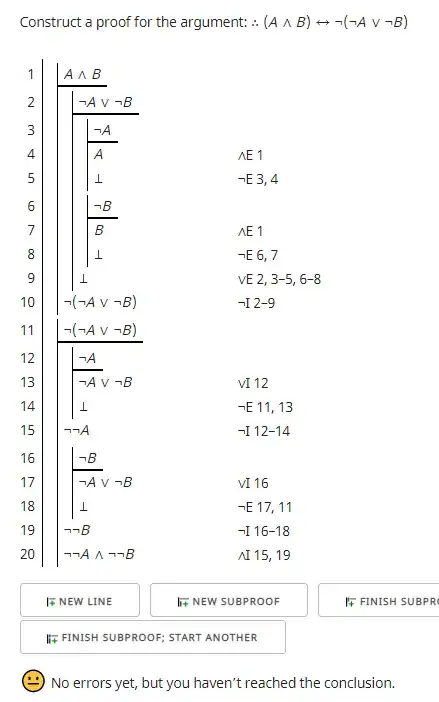

The OP asks for a proof of DeMorgan's laws with the following restriction:
We are allowed to use the introduction and elimination of the following operators: ¬,∧,∨,⇒⟺
No other rules are allowed.
Essentially we are restricted to intuitionistic natural deduction inference rules. However, according to the answers to this question Do De Morgan's laws hold in propositional intuitionistic logic?, not all of the four DeMorgan's laws can be shown using intuitionistic logic.
Here is an attempt at a proof that cannot be finished because I am not allowed to use double negation elimination nor indirect proof which I would have used on lines 15 and 19. All I can derive is $\neg \neg A \land \neg \neg B$ which I derive as a compromise on line 20:
Kevin Klement's JavaScript/PHP Fitch-style natural deduction proof editor and checker http://proofs.openlogicproject.org/
Frank Hubeny
  • 1,603
  • See Bram28's answer. The rule called "negation elimination" in Symbolic Logic by David W. Agler, is known as "indirect proof (IP)" in the Open Logic Projects' proof checker. – Graham Kemp Aug 14 '19 at 22:22
  • @GrahamKemp I don't think Bram28's answer is correct. Lines 20 and 24 reference incorrectly $\neg E$. That rule derives the absurdity symbol. See my lines 14 and 18. What Bram28 is using is called indirect proof as you mention. That implies double negation elimination which cannot be derived using the permitted inference rules for this question. – Frank Hubeny Aug 15 '19 at 13:53
  • As pointed out, different texts define the rules differently. The OP's text does not use the absurdity symbol, just contrary statements. What it calls negation elimination is: when assumption of a negative derives contradictory statements, you may discharge the assumption to infer the positive. – Graham Kemp Aug 15 '19 at 20:36
  • @GrahamKemp The OP was given the problem with a constraint to use only certain rules. That is all. The details of those rules were not specified. My suspicion is that the OP was given the problem to show something that could not be shown with intuitionistic rules. – Frank Hubeny Aug 15 '19 at 21:04
  • Yes, but just listing the name of the rules is often not sufficient, since different systems use the same names for different rules. There isn't a single standard (and that is annoying). When quizzed on this in the comments, the OP clarified that the book was David W. Agler's Symbolic Logic: Semantics, Syntax, and Proof. – Graham Kemp Aug 15 '19 at 22:33
  • So your proof isn't wrong; it just uses a different system to the OP's preference. That is just something to be aware of when answering questions. – Graham Kemp Aug 15 '19 at 22:35
