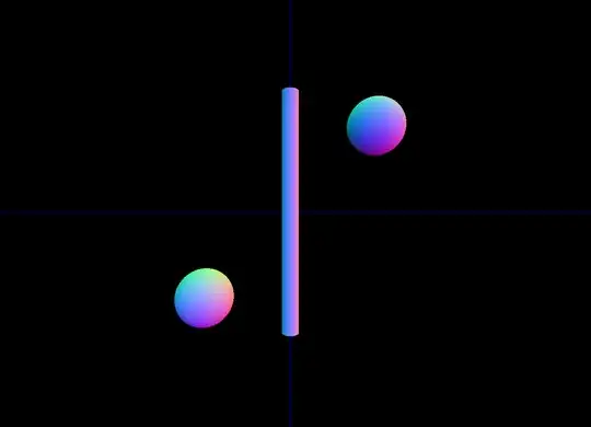

I think I am not able to convey what I need so here is the edited question:
plot image
As you can see in the image, a point on the left is at $(-3,-3,0)$ and the point on the right is at $(3,3,0)$.
And when I draw the cylinder it spawns at $(0,0,0)$, the center point of the cylinder is at $(0,0,0)$ and size of the cylinder is the distance between $2$ points. Now my goal is to rotate the cylinder in all $x$, $y$ and $z$-axis so that it connects both the points.
Here this is a $2$D image so I know that I will need to rotate this only in z-axis but I want a generalized for the points anywhere in the coordinate system.

  • What is the initial orientation of your cylinder? Which vector is its starting axis? – G Tony Jacobs Nov 15 '17 at 18:56
  • Starting axis is the origin and my code draws cylinder vertically at the origin. – Samvid Jhaveri Nov 15 '17 at 19:05
  • So, the initial axis is $(0,0,1)$, and you want to rotate to the axis which is the vector from $(1,0,0)$ to $(1,1,1)$? – G Tony Jacobs Nov 15 '17 at 19:07
  • The question you asked is not the information you need to know. You need to know the rotation matrix from the axis of your initial cylinder to the vector $(0,1,1).$ To build this matrix you can use an angle (but not the angle you asked for!) and an axis of rotation, or you can use other methods. – David K Nov 15 '17 at 19:18

A straightforward way is to use the dot or scalar product of two vectors. $$ \vec{u}\cdot \vec{v} = |\vec{u}||\vec{v}|\cos\theta $$ Here $\theta$ is the angle formed by $\vec{u}$ and $\vec{v}$ when they are tail-to-tail. $\vec{u}\cdot \vec{v}$ is easy to compute using components as $\vec{u}\cdot \vec{v} = u_1v_1 + u_2v_2 + u_3v_3$ so $$\cos\theta = \frac{u_1v_1 + u_2v_2 + u_3v_3}{\sqrt{u_1^2+u_2^2+u_3^2}\sqrt{v_1^2+v_2^2+v_3^2}}\ .$$
In your case you have $$\cos\theta = \frac{1}{\sqrt{3}}\ .$$
OK, I'll try to use the above to answer the clarified question:
I will assume that your cylinder spawns with the $z$-axis as the cylinder axis. If this is not true, then you will have to modify what follows. You talk about rotating about all $x$, $y$, and $z$-axis, but actually only two rotations are necessary to rotate a vector that points in the positive $z$-direction to point in an arbitrary direction. Suppose you want to rotate the vector $\vec{k}$ to point in the direction $<a_1,a_2,a_3>$.
spherical coordinates
By Dmcq (Own work) [CC BY-SA 3.0], via Wikimedia Commons
The angle $\varphi$ is the angle between $\vec{k}$ and $\vec{a}$ and can be found from the above as $$ \varphi = \arccos\left(\frac{a_3}{\sqrt{a_1^2+a_2^2+a_3^2}}\right)$$
The angle $\theta$ is the angle between the positive $x$-axis and the projection of $\vec{a}$ onto the $xy$-plane. $$ \theta = \arccos\left(\frac{<1,0,0>\cdot<a_1,a_2,0>}{|<a_1,a_2,0>|}\right) = \arccos\left(\frac{a_1}{\sqrt{a_1^2+a_2^2}}\right)$$ The expression for $\theta$ is only true if $0\leq\theta\leq 180$. If $\theta >180$ ($y<0$) you will have to patch it up.
Take your cylinder, rotate by $\varphi$ about the $y$-axis (counter-clockwise looking at the $xz$-plane from the positive $y$-axis), then rotate by $\theta$ about the $z$-axis.

  • It is the same answer as previous one and my question is the original position of the cylinder is at (0,0,0) so after finding the 'Theta' value how can I apply rotation in all x,y,z-axis to make it align to the direction this is facing? – Samvid Jhaveri Nov 15 '17 at 19:18
  • Yes, I was typing it at the same time. This is the answer to your question, if this is not the question that you need answered then you need to clarify your question. – Malcolm Nov 15 '17 at 19:21
  • I'm not getting that same answer. Note that the target orientation is actually the vector $(0,1,1)$ – G Tony Jacobs Nov 15 '17 at 19:22
  • " have 2 points in 3-dimensional space and I want to find the angle between them with respect to the origin as I have to draw a cylinder between them." The angle between them with respect to the origin is not the angle between $<0,0,1>$ and $<1,1,1>$? Ok, then the question is even less clear to me. – Malcolm Nov 15 '17 at 19:25
  • @Malcolm my apologies if I am not able to convey the information properly. I have updated the question please check it. – Samvid Jhaveri Nov 15 '17 at 19:45

  • But I think I can move the cylinder to one point, i.e. (-3,-3,0) and then how can I rotate it towards another point? – Samvid Jhaveri Nov 15 '17 at 20:18
  • I still don't know what you are trying to accomplish or why. You somehow have a cylinder of unspecified height and radius with its center at the origin. You want the do rigid rotations and translations of this cylinder to move it to some other place and some other orientation. (Limiting yourself to rotations and translations means that the height and radius will not change.) – DREKT Nov 17 '17 at 19:22
  • If you want to do a rigid rotation of the axis from its (apparent) starting position along the z axis to some other vector, v, this is a rotation around the axis determined by the cross product of the z axis with v through an angle determined by the arccos formula above. – DREKT Nov 17 '17 at 19:25
You have two vectors $\mathbf{v}_1$ and $\mathbf{v}_2$ and you want the angle between them. The answer is
$$\theta = \tan^{-1} \left( \frac{\| {\bf v}_1 \times {\bf v}_2 \|}{{\bf v}_1 \cdot {\bf v}_2} \right)$$
In terms of an algorithm see this post with code and an example.
I tent to use the Atan2(y,x) function because it handles the fringe cases better. When the two vectors are perpendicular the methods that rely on Acos() can fail. And the methods that use Asin() fail when the two vectors are parallel.
