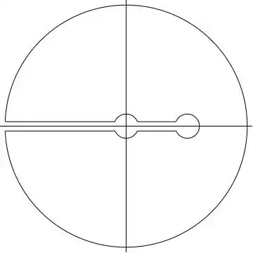

It turns out that this integral can be evaluated using complex analysis techniques. And, I am happy to report, this approach leads to a formulation that I have never seen before, and the analysis involves an unexpected use of residues.
OK, so to begin we define a complex integral with an integrand and a contour of integration as follows:
$$\oint_C dz \, \frac{\log^2{z}}{\sqrt{z (z-1)}} $$
where $C$ is the following contour:
with the large arc having radius $R$ and the small arcs having radius $\epsilon$. By Cauchy's theorem, the integral is zero. Then again, by parametrizing the various portions of $C$, the complex integral above is also equal to
$$e^{i \pi} \int_R^{\epsilon} dx \frac{\left ( \log{x}+i \pi \right )^2}{e^{i \pi} \sqrt{x (x+1)}} + i \epsilon \int_{\pi}^0 d\phi \, e^{i \phi} \frac{\left ( \log{\epsilon}+i \phi \right )^2}{\sqrt{\epsilon e^{i \phi} \left ( \epsilon e^{i \phi} - 1 \right )}} \\ + e^{-i \pi/2} \int_{\epsilon}^{1-\epsilon} dx \frac{\log^2{x}}{\sqrt{x (1-x)}} + i \epsilon \int_{\pi}^{-\pi} d\phi \, e^{i \phi} \frac{\left ( \log{\epsilon}+i \phi \right )^2}{\sqrt{ \left (1 + \epsilon e^{i \phi} \right ) \epsilon e^{i \phi}}} \\ + e^{i \pi/2} \int_{1-\epsilon}^{\epsilon} dx \frac{\log^2{x}}{\sqrt{x (1-x)}} + i \epsilon \int_0^{-\pi} d\phi \, e^{i \phi} \frac{\left ( \log{\epsilon}+i \phi \right )^2}{\sqrt{\epsilon e^{i \phi} \left ( \epsilon e^{i \phi} - 1 \right )}} \\ + e^{-i \pi} \int_{\epsilon}^R dx \frac{\left ( \log{x}-i \pi \right )^2}{e^{-i \pi} \sqrt{x (x+1)}}+ i R \int_{-\pi}^{\pi} d\theta \, e^{i \theta} \frac{\left ( \log{R} + i \theta \right )^2}{\sqrt{R e^{i \theta} \left ( R e^{i \theta} - 1 \right )}} = 0\tag{1}$$
In the limit as $\epsilon \to 0$, the second, fourth, and sixth integrals approach zero. We can then combine the first and seventh integrals, and the third and fifth integrals (and note the significant cancellations). We then have, after rewriting the eighth integral:
$$-i 4 \pi \int_0^R dx \, \frac{\log{x}}{\sqrt{x (1+x)}} - i 2 \int_0^1 dx \frac{\log^2{x}}{\sqrt{x (1-x)}} \\ + i \int_{-\pi}^{\pi} d\theta \, \left ( \log^2{R} + i 2 \theta \log{R} - \theta^2 \right ) \left ( 1 - \frac1{R e^{i \theta}} \right )^{-1/2} = 0\tag{2}$$
As $R \to \infty$, the last factor in the third integral approaches $1$, so we can ignore it. Accordingly, after rearranging the above equation, we have the following expression for the original integral:
$$\int_0^1 dx \frac{\log^2{x}}{\sqrt{x (1-x)}} = \lim_{R \to \infty} \left (-2 \pi \int_0^R dx \frac{\log{x}}{\sqrt{x (1+x)}} + \pi \log^2{R} - \frac{\pi^3}{3} \right )\tag{3}$$
