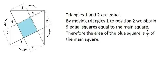

By moving small triangles we can make $5$ equal small squares. enter image description here
Seyed
  • 9,041
    How do you know that moving 1 to 2, you obtain a square (or, in other words, that the segments connecting the vertices of the squares have the same length as the inner square side)? – OxTaz Nov 13 '17 at 20:40
    @OxTaz, those triangles 1 and 2 are right triangles, their hypotenuse are equal and their opposite angles are congruent. Therefore triangles 1 and 2 are equal. – Seyed Nov 13 '17 at 20:59
    How do you know that long edge from corner of inner square to corner of outer square is equal to length of side of blue square? That does not seem obvious to me. – Jiminion Nov 13 '17 at 22:06
    @Jiminion, Lines are drawn from vertices of the main square to the middle of the opposite sides. In the large right angled triangle (triangle 1 and a part of small square) the line is parallel to the small leg divides both the hypotenuse and the other leg into two equal parts. – Seyed Nov 13 '17 at 22:23
    @Jiminion I had the same issue. Then I noticed that the long leg of triangle 1 starts as the "height" of a new square, but after the rotation it is the "width" of a new square, thus it is in fact a square. (And after rotation the "width" of the new square is clearly equal to the side-length of the blue square). – Gregor Thomas Nov 15 '17 at 19:42
  • A clearer reason why the lines are the same size is that after moving the small triangle, one is left with an object with at least 3 90 degree corners and one side that is the length of the blue box side. This can only be a square, with all corners 90 degrees, and all sides the same length as the blue box side(s). – Jiminion Nov 27 '17 at 22:08

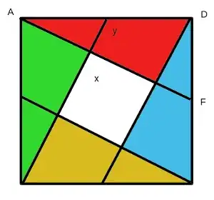

Let $x$ be the area of the inner square, and $y$ be the area of each of the four coloured triangles shown in the picture below:
So we have: $x+4y=1$
Now each of these triangles has the same shape as $ADF$ which has hypotenuse $AF = \frac{\sqrt{5}}{2}$. The area of such a triangle is $\frac{h^2}{5}$ where $h$ is the hypotenuse, since this makes the area of the $ADF$ triangle exactly $\frac{1}{4}$ square centimeters. The hypotenuse of each coloured triangle is $1$, so we can now solve $y=\frac{h^2}{5}$ with $h=1$, and thus $y=\frac{1}{5}$, which gives the solution $x=1-4y=\frac{1}{5}$.

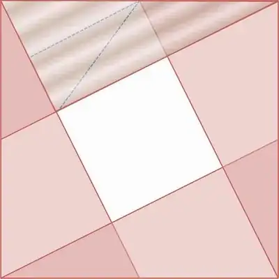

Obviously I prefer @Michael Rozenberg's solution, as its straightforward to adapt for E, F, G, H not middle-points (clearly if AH=0 then the inner square is the outer square and the answer is 1; the posed question is AH=1/2 with answer 1/5; the other limit AH=AD=1 then clearly the answer is 0, but what of the intermediate values?).
So, to visually answer the question I'd go with a variation on the solution by @DeltaScuti_Fomalhautb. My large pink triangles are clearly each 1/4, so if subtracting them each from the main square (1-4* 1/4 =0), the leftover inner square is exactly what I've double-subtracted (the four darker shaded overlaps, one in each corner of the original square; ignore the extra stripey overlay).
Construction
Now to show that five of these double-counted triangles together make up my large pink triangles is obvious: The top-left pink triangle consists of the 'stripey-shaded' medium-sized triangle plus one of the overlappers, and the 'stripey-shaded' one is exactly four times the little overlapper it contains at it's right-hand point (it's congruent with the little one, and its hypothenuse is exactly twice the little one's hypothenuse, so its surface is four times the little one's). So in summary this proves the little square is four times the little overlap-triangle, each of which is 1/5 of the pink triangle which was 1/4 of the original square; so the little square is 4* 1/5 * 1/4 = 1/5.
Ignore the blue dotted lines, they'd give you another way to see it's five of those little triangles, but it's slightly more work to argue --- e.g., at this point I haven't established that the inner square's side is equal to the overlapper's base, and the dotted lines thus define shapes that seem congruent with the overlappers but might not be (like in that trick where you divide a rectangle into triangles but 1/16 or so gets lost as two lines aren't exactly parallel though drawing in fat pencil they seem; sorry can't find a link now).

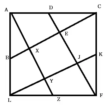

Let us borrow Inceptio's figure:
Since $ABX,\,ALY$ and $AZL$ are similar right-angled triangles (why?) and $B$ is the midpoint of $AL$, we conclude that $AX=XY$. For the similar reason, we have $AX=XY=LY=YJ=EJ=JF=XE=EC=\ell$ (say).
Furthermore, as $ABX$ and $ALY$ are similar right-angled triangles and $B$ is the midpoint of $AL$, we have $BX=\frac\ell2$. By similar reason, $BX=YZ=JK=DE=\frac\ell2$.
Therefore, if you glue the triangle $ABX$ and the trapezoid $BLXY$ together, you get a square with side length $\ell$. Similarly for the other three pairs of small triangles and trapezoids. As the square at the centre also has side length $\ell$, we see that its area is $\frac15$ the area of the large square.

Let us happily borrow Inceptio's image:
Note that $\,\Delta ALZ\cong\Delta LFK\cong\Delta FCD\cong \Delta CAB\,$ as these all are right-angled triangles with legs of the same sizes $\,1\,,\,0.5\,$ .
The sum of these four triangle's areas is $\,0.25\cdot 4=1\;\;(**)\,$ , but note that the areas of the little triangles $\,\Delta ABX\,,\,\Delta LZY\,,\,\Delta FKL\,,\,\Delta CED\,$ are summed twice in the above calculation.
Now, we prove all these four little triangles are congruent to each other and right-angled. From the first congruence above we get:
$$\alpha:=\angle LAZ=\angle FLK=\angle DFC=\angle ACB$$
and, for example, in the triangle $\,\Delta ALZ\,$ , we get $\,\beta:=\angle AZL=90^\circ-\alpha\,$ , so in the triangle $\,\Delta LZY\,$ we have the pair of angles $\,\alpha\,,\,\beta\,\,,\,\,\,\alpha+\beta=90^\circ\,$ , and from here that this little triangle is right- angled. The same holds for the other three little triangles.
We also got the additional fact that $\,XEJY\,$ is a rectangle as its four angles are right, and in a little while more it will follow that it is actually a square.
From (**) above and the lines after it, it follows that the area of $\,XEJY\,$ equals the sum of the four little triangles.
We also get that the four trapezoids in the figure are congruent (as two of their sides are parts of the congruent little triangles and a third side equals the length of their hypotenuses, which is $\,0.5\,$ .
Now it is clear that $\,XE=EJ=JY=YX\,$ (since, for example, $\,XE=BC-BX-EC=$ (hypotenuse of big right angled triangle minus short lef of tine right-angled triangle-hypotenuse of tiny right angled triangle) and, as promised above, it follows $\,XEJY\,$ is in fact a square.
I now believe you can complete the exercise.
