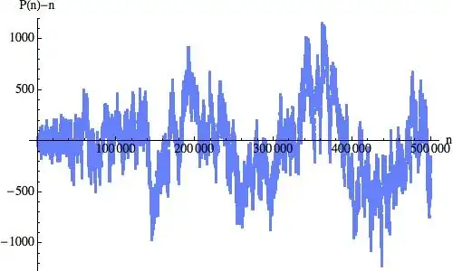

I was wondering how quickly this sequence grows and it seems that P(n) is very close to n, asymptotically speaking. Is there a reason for it? What are good bounds for $|P(n)-n|$?
For the first half milion values I calculated it below.
empirical data
