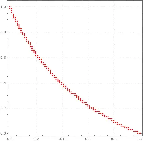

Numerical experiment
The following numerical experiment yields, as we will see later, the correct assumptions for getting a good candidate for the optimum. Convexity will help us show that this candidate is indeed the optimum.
We plot the active set of the optimum of a discretization: active set
This is the output of the following code: activeset[k_] := Module[{h, constraints, vars, objective, optresult, result, pts}, h = 1/(2 k - 2); constraints = Flatten[Table[ Table[x[i] x[j] >= (2 k - i - j) h, {j, i, k}], {i, 1, k}]]; constraints = Join[constraints, Table[x[i] >= 0, {i, 1, k}]]; vars = Table[x[i], {i, 1, k}]; objective = Sum[x[i], {i, 1, k}] + Sum[x[i], {i, 2, k - 1}]; optresult = FindMinimum[{objective, constraints}, vars, Method -> "InteriorPoint"]; result = Table[{(i - 1) h, x[i]}, {i, 1, k}] /. optresult[[2]]; pts = Select[Flatten[Table[{i, j}, {i, 1, k}, {j, 1, k}], 1], Abs[x[#[[1]]] x[#[[2]]] - (2 k - #[[1]] - #[[2]]) h] < 10^(-5) /. optresult[[2]] &]; ListPlot[(pts - 1)/(k - 1), AspectRatio -> 1, PlotStyle -> Red, PlotTheme -> "Detailed"] ]; activeset[71]
