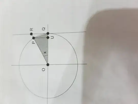

Can someone help me prove that $0 \leq 1 -\cos(x) \leq x^2/2$
The hint from the book, was that I could assume that $ x \in (0, PI/2), $ then I could use Pythagoras' to realise that $ |QP| = \sqrt(2 -2cosx)$ and use that the line QP must be shorter than the arc lenght between the two points. And from there I can use the same arguemnt for $ x \in (Pi/2, PI)$. But I don't quite understand what to do.

    What can you use? – José Carlos Santos Nov 06 '17 at 08:39
    Can you use Taylor series? If not, first consider that for angles in the 1st quadrant, $\sin x \le x \le \tan x$ – PM 2Ring Nov 06 '17 at 08:45
  • The hint from the book, was that I could assume that $ x \in (0, PI/2), $ then I could use Pythagoras' to realise that $ |QP| = \sqrt(2 -2cosx)$ and use that the line QP must be shorter than the arc lenght between the two points. And from there I can use the same arguemnt for $ x \in (Pi/2, PI)$. But I don't quite understand what to do. – tonytouch Nov 06 '17 at 08:48

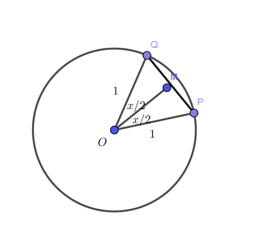

Based on what you have written in comments about your textbooks idea: consider the unit circle with center at $O$ and points $P$ and $Q$ on the circle such that $\angle POQ=x$. Let us assume that $x \in (0, \pi/2)$. enter image description here
Consider the $\triangle POQ$, let $OM$ be the perpendicular from $O$ onto the line $PQ$. In $\triangle OMP$, we have $$\sin \left(\frac{x}{2}\right)=\frac{MP}{OP}=\frac{MP}{1}=MP.$$ Thus the segment $PQ=2MP=2\sin \left(\frac{x}{2}\right)$.
Since the arc $PQ$ is greater than or equal to the line segment $PQ$, therefore we have $$\text{segment }PQ = 2\sin \left(\frac{x}{2}\right) \leq x=\text{arc }PQ.$$ This implies \begin{align*} 2\sin \left(\frac{x}{2}\right) &\leq x\\ 2\sin^2 \left(\frac{x}{2}\right) &\leq \frac{x^2}{2}\\ 1-\cos x & \leq \frac{x^2}{2}. \end{align*}

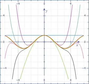

Successive upper and lower polynomial bounds of the cosine:
