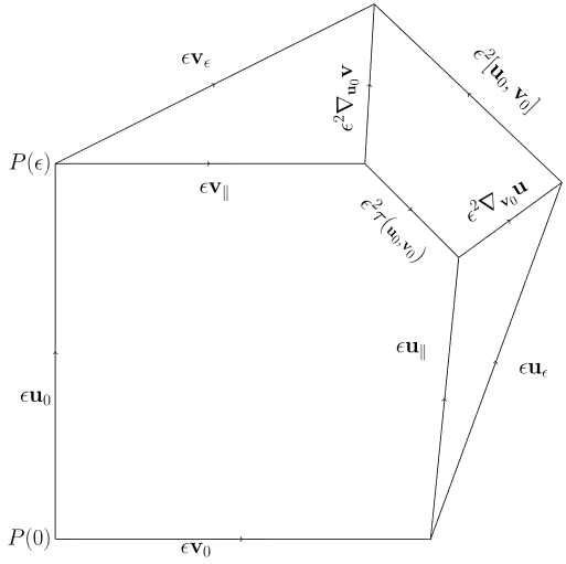

In simple words(not formal): The torsion describes how the tangent space twisted when it is parallel transported along a geodesic. The Lie bracket of two vectors measures, as you said, the failure to close the flow lines of these vectors.
The main difference is that torsion uses parallel transport whereas Lie bracket uses flow line.
This image is not mine. I saved it from MSE months ago

  • The Lie bracket is included in the definition of the torsion. So, the flow line information is also encoded in the torsion. Also, are you sure that the torsion has to do with parallel transport only along geodesics? I thought that it's about parallel transport along any curve. Lastly, when some people try to explain torsion, they refer to the twisting of coordinate frames(as in moving coordinate axis) as we perform parallel transport along curves. How does your explanation tie into that? Thank you. – TheQuantumMan Nov 01 '17 at 21:59
