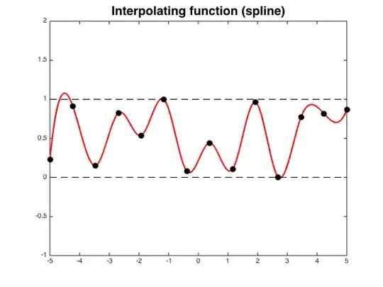

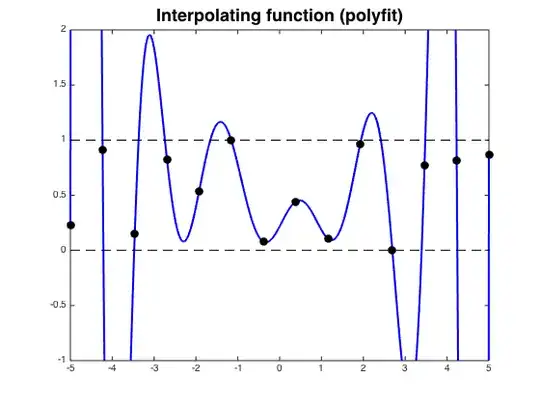

The main motivation for using splines instead of a single polynomial is to avoid the oscillations in high-degree interpolating polynomials that can occur between interpolation points.
Cubic splines allow $C^2$ interpolants, which are important in applications such as computer-aided design.
Here is an example of oscillations from this page:
