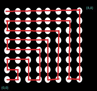

The following (ugly, sorry) picture shows the desired map.
  • Your 'ugly' PAC-MAN picture inspired me! – CopyPasteIt Oct 21 '17 at 12:17
  • I don't see how you define this bijection? Yeah, it's clear that this idea can be extended to a bijection. But now can you please write a formula which defines it? (Or alternatively, draw a picture over the whole infinite grid...) I want to know what is the pair $(n,m)$ which is mapped to $2^{100}-5^{36}$. – Asaf Karagila Oct 21 '17 at 12:32
    @AsafKaragila Oh sure, that one is $$(658125460370987,1125893444475543)\mapsto 2^{100}-5^{36}$$ – user469689 Oct 22 '17 at 03:04
  • For all I know, these are two randomly generated numbers. – Asaf Karagila Oct 23 '17 at 13:07
  • @AsafKaragila I understand what you are saying. I haven't had time to write out the explicit map for this, and will soon. It's true that finding that specific map wasn't particularly quick. I found the $n$ and that $n^2<2^{100}-5^{26}<(n+1)^2$ and then I classified when the next 'square' begins based on whether the 'square' is of even or odd side length, and then I counted backwards from the $(n+1)^2$ until I reached the correct node. – user469689 Oct 23 '17 at 14:24
    I'm not saying that I don't believe you that you did that. I'm just saying, there is no way for me to verify the correctness of your answer. :) – Asaf Karagila Oct 23 '17 at 14:26

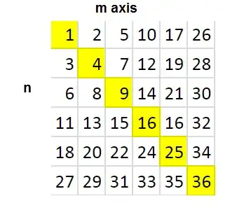

I used google sheets to verify; here is the visual:
Using induction on the $n \times n$ squares, you can wrap this up.
Exercise: Show that $\pi$ is bijective.
Note: The google sheet/image is off in the $(m,n) = (5,4)$ cell; the correct entry is $\pi(5,4) = 23$.
