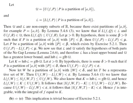

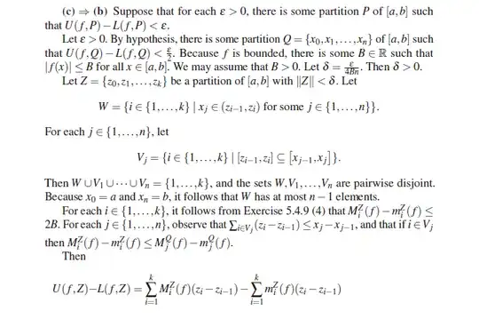

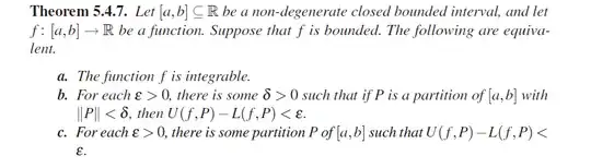

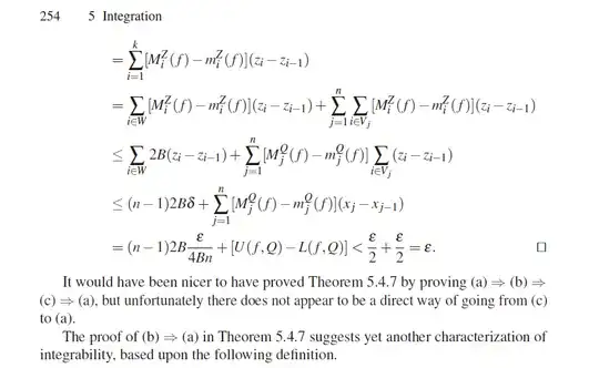

Update: My reference. (From Ethan D. Bloch "The Real Numbers and Real Analysis") The author first proved (a)$\Rightarrow$(b), then (b)$\Rightarrow$(a). Then (b)$\Rightarrow$(c), which is trivial. Then (c)$\Rightarrow $(b).
PS: I omit the $(a)\Rightarrow (b)$ part here. enter image description here enter image description here enter image description here
