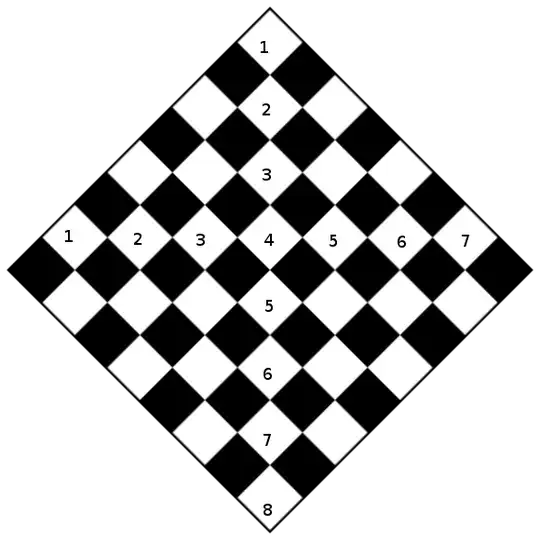

The easiest way I see to prove this via the pigeonhole is:
If you re-align the board as a diamond you can treat the white squares as a diamond shaped grid that's 8x7 where bishops move as rooks.
Since there are only 7 columns, there can be no solution beyond 7 in which two bishops are not in the same column (and thus attacking one another). This is also true for the black squares, which just a 90 degree rotation of the white squares. Therefore, using both colors, there are only 14 pigeonholes.
  • Simple! Thanks. I see that the aim is just to label the total amount of possible diagonals, and see that a $15th$ bishop will fall on to a pre-existing diagonal. – hs_math_enjoyer Oct 15 '17 at 05:25
