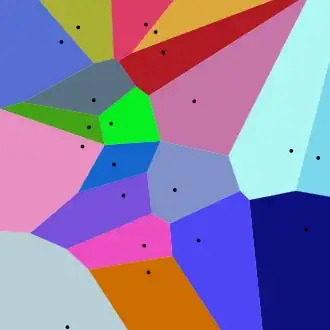

I could be wrong but what the concept you are looking for looks pretty much like a Voronoi diagram.
An excerpt form Wikipedia:
In mathematics, a Voronoi diagram is a partitioning of a plane into regions based on distance to points in a specific subset of the plane. That set of points (called seeds, sites, or generators) is specified beforehand, and for each seed there is a corresponding region consisting of all points closer to that seed than to any other. These regions are called Voronoi cells. The Voronoi diagram of a set of points is dual to its Delaunay triangulation.
And this is how it looks like (credits to Wikipedia):
There is a quite easy to follow algorithm to generate a Voronoi diagram of a given space. Basically you will require a "seed" of points to make the partitions. They can be random, so the cells will be random every time you apply the procedure from scratch.

    This concept is too strict: surely there are convex polygonal tesselations which don't arise from Voronoi diagrams. It's interesting to see whether the set of graphs is still the same; I suspect they aren't, but a counterexample would be nice to see. – Erick Wong Feb 08 '17 at 02:16
