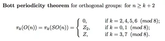

But generally there seem to be some relations, like this: enter image description here

    $SO(N)$ is the connected component of the identity of $O(N)$, so all of their $\pi_k$ agree, $k \ge 1$. – Qiaochu Yuan Oct 03 '17 at 04:52
    In the answer of the MO post you give there are also fibrations $SO(n-1)\rightarrow SO(n)\rightarrow S^{n-1}$ and $SO(n)\rightarrow O(n)\xrightarrow{det} \mathbb{Z}_2$ and $\mathbb{Z}_2\rightarrow Spin(n)\rightarrow SO(n)$. The first uses the action of $SO(n)$ on $S^{n-1}\subseteq \mathbb{R}^{n}$, the second is the determinant and the third is the universal cover.
    Hence all of $O(n)$, $SO(n)$, $Spin(n)$ have the same higher homotopy.

As pointed out in the comments, $O(N)$ consists of two connected components which are both diffeomorphic to $SO(N)$. So $\pi_0(O(N)) = \mathbb{Z}_2$, $\pi_0(SO(N)) = 0$, and for $m \geq 1$, $\pi_m(O(N)) = \pi_m(SO(N))$.
As for $\operatorname{Spin}(N)$, note that is it a double cover of $SO(N)$. When $N = 1$, we see that $\operatorname{Spin}(1) = \mathbb{Z}_2$ so $\pi_0(\operatorname{Spin}(1)) = \mathbb{Z}_2$ and all its other homotopy groups are trivial, while for $N = 2$ we have $\operatorname{Spin}(2) = S^1$ which has first homotopy group $\mathbb{Z}$ and all higher homotopy groups trivial. When $N \geq 3$, $\operatorname{Spin}(N)$ is the universal cover of $SO(N)$ so $\pi_1(\operatorname{Spin}(N)) = 0$ and for $m \geq 2$, $\pi_m(\operatorname{Spin}(N)) = \pi_m(SO(N))$.
The groups $\pi_m(SO(N))$ for $1 \leq m \leq 15$ and $1 \leq N \leq 17$ are given in appendix A, section 6, part VII of the Encyclopedic Dictionary of Mathematics. The table can now be found on nLab.
