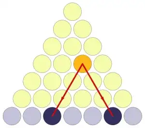

I was quite impressed by a beautiful proof1 of the formula for n'th triangular number — it's kind of a bijective proof built on the top of geometric summation idea.
Question: does this argument generalize to higher dimensions? i.e. can someone prove the formula for n-th «k-dimensional simplex number» this way?

Place the balls so that the corners of the pyramid have coordinates (1,1,1), (n,1,1), (1,n,1), (1,1,n). Then for the ball at (x,y,z) we see that (x,x+y,x+y+z) is an ordered triple of distinct numbers between 1 and n+2 inclusive. There are $\binom{n+2}{3}$ such triples, and they are clearly in one-to-one correspondence with the balls. Geometrically, this corresponds to drawing planes x=constant, x+y=constant, and x+y+z=constant through a given ball, and seeing where these planes intersect the x axis.
(To compare with the case $k=2$, "straighten" the picture above into a right triangle. Then the diagonal lines become lines x=constant and x+y=constant, and the bottom row of balls (the blue ones) can be identified with the points where these lines intersect the x axis.)
This also works in higher dimensions, giving $\binom{n+k-1}{k}$.
Whether this proof really is any different from the one you suggested in the question can of course be debated...
