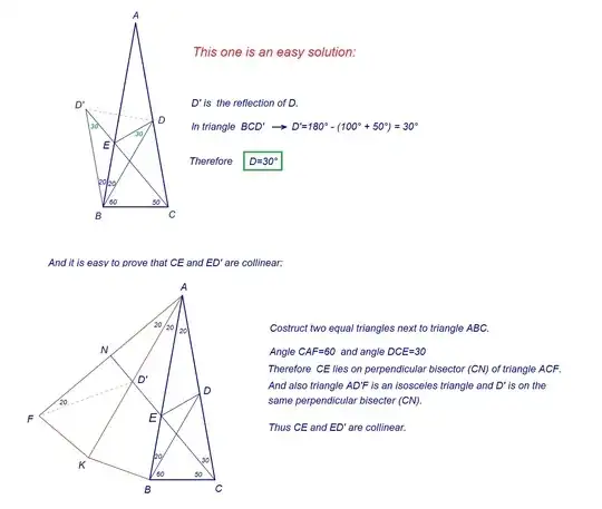

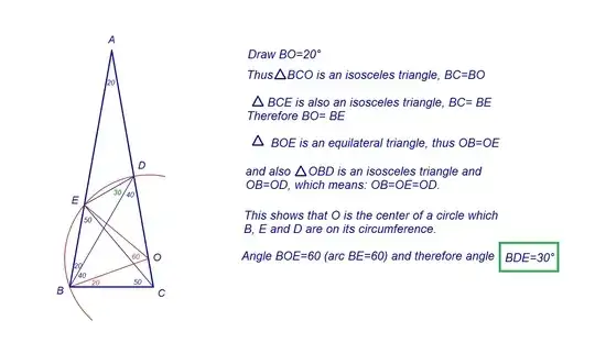

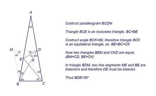

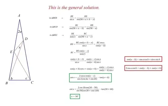

I have three different solutions and one general solution to your problem: enter image description here

  • What software did you use to write this answer? –  Oct 03 '17 at 21:00
    @Jack, I used the $Free$ C.a.r software to draw and typed in paint. You can download the software from here: http://car.rene-grothmann.de/doc_en/download.html – Seyed Oct 03 '17 at 23:26

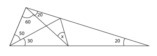

Hint: Start with the triangle with $50$ and $60$ degrees to obtain $70$. Then use the straight line angle $180=z+70$ to obtain the adjacent angles. Then use $360=70+110+110+w$ to find the last angle of the crossing.
