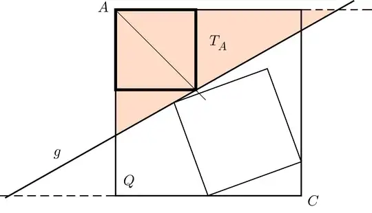

Given two nonoverlapping squares in a large square $Q$ there is a line $g$ separating the two squares. Assume $g$ is not parallel to one of the sides of $Q$ (otherwise we are done). Let $A$ and $C$ be the two vertices of $Q$ farthest away from $g$ on the two sides of $g$. The two edges of $Q$ meeting at $A$ together with $g$ determine a rightangled triangle $T_A$, and similarly we get a rightangled triangle $T_C$; see the following figure. (One could draw a second figure where $g$ cuts off just one vertex $A$. The proof remains the same.)
To finish the proof we need the following
Lemma. Given a triangle $T_C$ with a right angle at $C$ the largest square inscribed in $T$ is the square with one vertex at $C$ and one vertex at the intersection of the angle bisector at $C$ with the hypotenuse of $T$.
Sketch of proof of the Lemma:
Put $C$ at the origin of the $(x,y)$-plane, and let $(a,0)$, $(0,b)$ be the other two vertices of $T$. We may assume two vertices of the inscribed square on the legs of $T$. If $(u,0)$ and $(0,v)$ are these two vertices the other two vertices are $(u+v,u)$ and $(v,u+v)$. It follows that $u$ and $v$ have to satisfy the conditions $$u\geq0, \quad v\geq 0,\quad {u+v\over a}+{u\over b}\leq 1,\quad {v\over a}+{u+v\over b}\leq 1\ .$$ These four conditions define a convex quadrilateral $P$ in the "abstract" $(u,v)$-plane. The vertices of $P$ are $$V_1=(0,0),\quad V_2=\Bigl({ab\over a+b},0\Bigr),\quad V_3=\Bigl({a^2b\over a^2+ab +b^2},{ab^2\over a^2+ab +b^2}\Bigr), \quad V_4=\Bigl(0,{ab\over a+b}\Bigr)\ .$$ Computation shows that $$|V_2|^2-|V_3|^2={a^4 b^4 \over(a+b)^2(a^2+ab+b^2)^2}>0\ .$$
Therefore $u^2+v^2$ ($=$ the square of the side length of our square) is maximal at the two vertices $V_2$ and $V_4$ of $P$, which correspond to the statement of the Lemma.

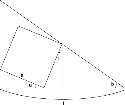

For the "square in triangle" subproblem, I think the solution always looks like test
where $0 \leq a \leq b$. If $a > b$, then just flip the figure around the $x=y$ line.
With the notations in the figure (if you don't like them, you can file a complaint), we have $t = s(\cos a + \sin a + \cos a / \tan b)$ so we have to minimize $f(a) = \sin a + (1 + 1 / \tan b) \cos a$.
Analyzing the derivative, I found that the function is increasing up to $\tan a = 1 / (1 + 1 / \tan b)$ and then decreasing, so the minimum is at one of the extremes: $a = 0$ or $a = b$
We get $f(0) = 1 + 1 / \tan b = (\sin b + \cos b) / \sin b$ and $f(b) = \sin b + \cos b + \cos^2b / \sin b = (1 + \sin b \cos b) / \sin b$.
Since $0 < \sin b$, $\cos b < 1$, we have $(1 - \sin b)(1 - \cos b) / \sin b > 0$ therefore $f(0) < f(b)$ so we get the biggest square for $a = 0$.

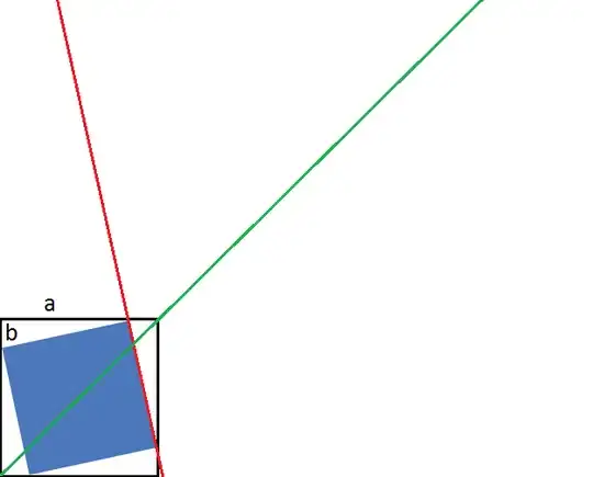

Proof of Lemma 2: We look for the intersection of the diagonal $x = y$ with the line extended from the hypotenuse of the top-right triangle. That is, the green and red lines from the image below:
Now the equation of the red line is $y = -(\frac{a}{b})x + c$ for some $c$.
To find this c, we just use the fact that that value of $y$ at $x = a$ for the red line is $a + b$. Putting this into the equation we get: $ a + b = -(\frac{a^2}{b}) + c$. From here we get $ c = (\frac{a^2 + b^2 + ab}{b})$. So the equation of our line becomes: $y = -(\frac{a}{b})x + \frac{a^2 + b^2 + ab}{b}$. Intersecting with the line $x = y$, the green line, we get: $x = -(\frac{a}{b})x + \frac{a^2 + b^2 + ab}{b}$, and after some algebraic manipulation, this works out as: $x = \frac{a^2 + b^2 + ab}{a + b}$.
At this point, it's good to reiterate the meaning of $x$. This is the size of the largest square that fits orthogonally into the bottom left corner of the black bounding box without intersecting the top-right waste triangle. Equivalently, it is the largest such square that doesn't intersect the red line. All we have now to prove, to show that the blue square can be placed in this corner, is that the side of the blue square is less than or equal $x$. So our goal is to solve the inequality:
$\sqrt{a^2 + b^2} \leq x$
Substitute our term for $x$:
$\sqrt{a^2 + b^2} \leq \frac{a^2 + b^2 + ab}{a + b}$
Positive terms allows squaring both sides:
$a^2 + b^2 \leq \frac{(a^2 + b^2 + ab)^2}{(a + b)^2} \equiv$ $(a^2 + b^2)(a + b)^2 \leq (a^2 + b^2 + ab)^2$
Now let $u = a^2 + b^2$ yielding:
$u(a + b)^2 \leq (u + ab)^2$
Now multiply it all out:
$ua^2 + ub^2 + 2uab \leq u^2 + a^2b^2 + 2uab \equiv$ $ua^2 + ub^2 \leq u^2 + a^2b^2$
And plug back in our term for $u$ getting:
$a^4 + 2a^2b^2 + b^4 \leq a^4 + b^4 + 2a^2b^2 + a^2b^2 \equiv$ $0 \leq a^2b^2$
Which is clearly true. And we're done proving the lemma.
