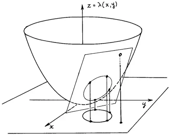

Four points $a,b,c,d$ are cocircular iff the determinant below is zero: $$ \begin{vmatrix} x_a&y_a&x_a^2+y_a^2&1\\ x_b&y_b&x_b^2+y_b^2&1\\ x_c&y_c&x_c^2+y_c^2&1\\ x_d&y_d&x_d^2+y_d^2&1\\ \end{vmatrix} $$
The sign of the determinant tells us whether $d$ is inside, on, or outside the (oriented) circle determined by $a,b,c$. Here is a picture illustrating this, from the classic paper Primitives for the Manipulation of General Subdivisions and the Computation of Voronoi Diagrams by Guibas and Stolfi:
