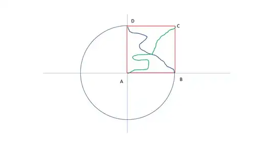

Well...here's a kind of proof, assuming you know how to compute integrals. Put the square with $A$ at the origin of the plane, $B$ to the right, along the $x$ axis, and $D$ above, on the $y$ axis. Now add to the curve $b$ the 3/4 arc of a circle from $D$ to $B$, as in this picture:enter image description here
You can now take the entire blue curve, which is a loop, agree to traverse it counterclockwise, and compute its winding number around the point $A$ by writing down an integral (see Wikipedia for what integral defines the winding number). Because all along the curve $b$, the angle from $A$ is in the first quadrant, it's not too hard to show that this winding number is $1$.
On the other hand, if you compute the winding number around the point $C$, it turns out to be $0$, for similar reasons.
For each point $u$ of the curve $a$, you could similarly compute the winding number around $u$. Then you have to show that if $u$ is never a point of $b$, that this winding number is a continuous function of the location of $u$. That requires some calculus, probably Leibniz' theorem.
Finally, suppose that curves $a$ and $b$ do not intersect. Then the winding number $w(u)$ is a continuous function of $u$ as $u$ moves from $A$ to $C$, but this continuous function is $1$ at $A$ and $0$ at $C$, and takes on only integer values. That is a contradiction, and hence the assumption that they don't intersect must be wrong.
This proof relies on $b$ being a nice enough curve that you can compute the winding number using integration; I'm not certain, but I suspect that "continuous" is probably enough, but I've been fooled before. It also depends on the continuity of integrals like the winding number with respect to the parameters like the center point around which the integral is computed -- that's messy calculus.
Still, this is at least a sketch of a solid non-algebraic-topology proof.

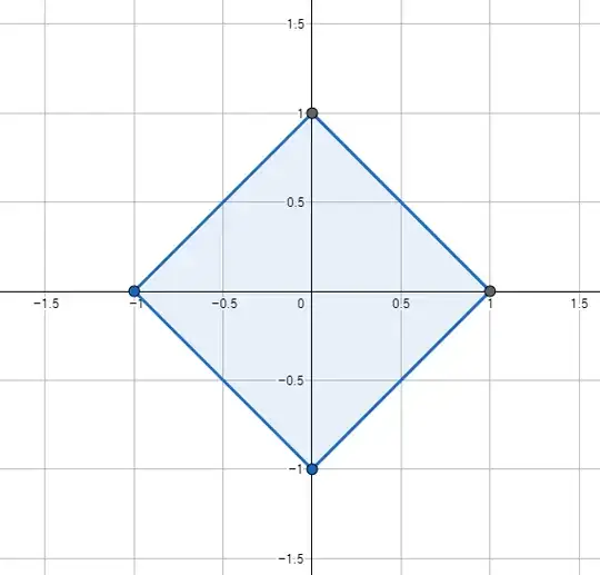

A graph\picture is at the bottom of this answer.
Lemma 1: Let $C \subset \mathbb R \times \mathbb R$ be a connected subspace containing both the points $(-1,0)$ and $(+1,0)$.
Then $C$ must have a nonempty intersection with the $y\text{-axis}$.
Proof: Exercise.
If we modify the $y\text{-axis}$ by changing the line segment connecting both $(0,+1)$ and $(0,-1)$ into a polygonal chain contained inside the blue square, lemma 1 will still be true.
Definition/Notation: Let $K$ be a compact connected set contained in the square and containing exactly two points from the perimeter of the square - $(0,+1)$ and $(0,-1)$. Then $K$ is called a distortion of the $y\text{-axis}$, and we denote by $K^{'}$ the union of $K$ with the line segment $(0,+1)\text{-UP}$ and the line segment $(0,-1)\text{-DOWN}$.
Assume now that the $C$ described in lemma 1 is also a closed subset of $\mathbb R \times \mathbb R$.
Proposition 2: $C \cap K^{'} \ne \emptyset$.
Proof
Suppose $C$ has an empty intersection with $K$. For each point in $K$ except for the 'end points', choose an open ball inside the blue interior of the square that does not intersect $C$. Do the same thing at the points $(0,+1)$ and $(0,-1)$; observe that for those two points, you get a disc wedge in the subspace topology on the square.
We choose a finite sub-cover of $K$. Starting at $(0,+1)$, there must be a polygonal chain inside the blue interior connecting it to $(0,-1)$. Each open ball intersects another open ball, and we construct line segments from the centers of the discs. An 'island of open balls' would mean that $K$ is not connected.
By construction, this linear chain does not intersect $C$. But then $C$ must intersect with $K^{'}$ outside the square. $\qquad \blacksquare$
