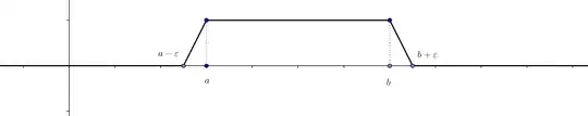

To do this fix $\phi \in L^\infty(\mathbb{R})$ and suppose that $$\tag{1}\int_{-\infty}^\infty \phi(x)f(x)\, dx=0, \quad \forall f\in C_c(\mathbb{R}).$$ We claim that $\phi=0$ almost everywhere. Indeed, let $a<b$ be fixed numbers. Approximate the characteristic function $\chi_{[a,b]}$ with a family $\chi^{(\varepsilon)}_{[a, b]}$ of "trapezoidal-like" functions:
trapezoidal function
We have $$\int_{-\infty}^\infty \left\lvert \chi_{[a,b]}(x)-\chi_{[a,b]}^{(\varepsilon)}\right\rvert\, dx = 2\varepsilon$$ so \begin{align} \left\lvert \int_{-\infty}^\infty \phi(x)\chi_{[a,b]}(x)\, dx - \int_{-\infty}^\infty \phi(x)\chi_{[a, b]}^{(\varepsilon)}(x)\, dx \right\rvert & \le \lVert \phi\rVert_{\infty} \int_{-\infty}^\infty \left\lvert \chi_{[a,b]}(x)-\chi_{[a,b]}^{(\varepsilon)}(x)\right\rvert\, dx \\ &=2\varepsilon \lVert \phi\rVert_\infty. \end{align} In particular, $$\int_a^b \phi(x)\, dx=\lim_{\varepsilon \to 0} \int_{-\infty}^\infty \phi(x)\chi_{[a,b]}^{(\varepsilon)}\, dx,$$ and the last limit is $0$ due to our assumption (1): indeed, every $\chi_{[a, b]}^{(\varepsilon)}$ is a continuous function with compact support. We have thus shown that $$\tag{2} \int_a^b\phi(x)\, dx=0, \qquad \forall a<b.$$ It is intuitively clear that this can happen only if $\phi=0$ almost everywhere: for a rigorous proof of this you can apply the Lebesgue differentiation theorem or Lemma 1 of this post. This proves the claim.

  • @GiusseppeNegro Thank you for your detailed answer. But would you write the definition of the trapezoidal-like function? – MorganeMaPh Aug 09 '16 at 06:47
