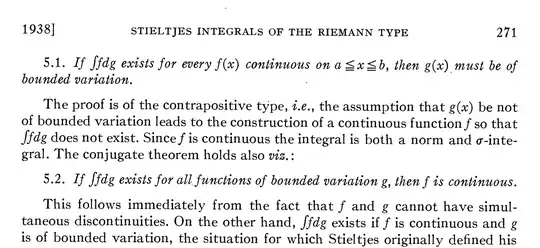

In Hildebrandt, T. H. (1938), "Definitions of Stieltjes Integrals of the Riemann Type", The American Mathematical Monthly, 45 (5): 265–278, it is stated without proof that
If $\int f dg$ exists for every $f(x)$ continuous on $a\leq x\leq b$, then $g(x)$ must be of bounded variation.
Hildebrandt
How do we prove such a statement? Should we use piece-wise linear functions alternating between 0 and 1 resembling step functions?? I don't see how I should proceed.. any advice would be welcome.
