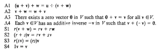

Do I just have to show it satisfies all the $A1 - A4, S1 - S4$ axioms?

$A1 = u + (v + w) = $

Satisfies one of the eight of the axioms. Is this what I am suppose to do?
If so, I don't get how to check the scalars for example
S1: $r(u + v) = ru + rv$
$$= r((a + b\sqrt{3}) + (c + d\sqrt{3}))$$
$$= r((a+c) + (b+d)\sqrt{3})$$
Unsure what to do after this

Yes, you should check that it satisfies all of the field axioms.
Note that the A1−A4, S1−S4 axioms you quote are not the axioms for a field! They are the axioms for a vector space (over an already given field). You should locate the actual list of axioms for a field. For example, there should be an axiom that guarantees the existence of multiplicative inverses. And there should not be any distinction between vectors and scalars.

The axiom you linked to are those of a vector space, not those for a field.
