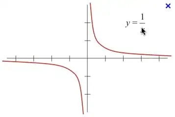

Show It Visually
  • Draw a graph of 1/x.
  • Pick a point on the x axis (2, for example)
  • show that you can approach 2 from the left side and the right side
  • in both cases, you can hit x=2 exactly, and the y value is .5
  • i.e. approaching from the left or from the right, you get close to the same y value.
  • Now do the same thing for x=0.
  • Approach from the right, and you can see that the y value gets larger and larger the closer you are to zero.
  • Approaching from the left, the y values gets smaller and smaller the closer you are to zero.
  • Unlike all the other numbers on the number line, approaching from the left doesn't get you to the same value as approaching from the right.
  • So, we generally say division by zero is not allowed, because there's not one clear answer as to what that value might be.
This allows someone to get the idea without having to understand a lot of notation.
