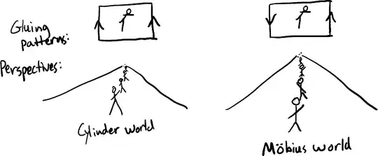

Let's talk about "flat" cylinders and Mobius strips, which means if you drew a triangle, the angles would add up to 180 degrees (versus curved space like a sphere or a Pringles(R) chip, where the sum of the angles are either more than or less than 180 degrees, respectively). Paper loops will give flat space, but it is worth thinking about it in a slightly different way:

@Shufflepants I might have cheated by thickening the space so there was anything to draw in perspective (geometry of Cartesian product with real line), or I might have drawn it ambiguously and those are embedded stick figures. – Kyle Miller Sep 06 '17 at 15:29

1@DarrenRinger If we must think about a 3d person, I was imagining that the gluing is done by a reflection through the XZ plane. If you do use the gluing you had in mind, imagine Mobius man is able to pass through the strip as if it were water, and if they had an eye on either side of the strip, one eye will see the back of their head reversed, and the other will see the back of their head with the usual orientation and twice as far away. (I believe http://geometrygames.org/CurvedSpaces/index.html have a mode illustrating what it would be like in such a 3d space but without the strip itself.) – Kyle Miller Sep 06 '17 at 17:24
@DarrenRinger Correction: with the double reflection gluing you were thinking of, that's just a 180 degree rotation, so you'll see the back of your head on both sides in the correct direction (neither reversed), but staggered as I said. – Kyle Miller Sep 06 '17 at 18:59
