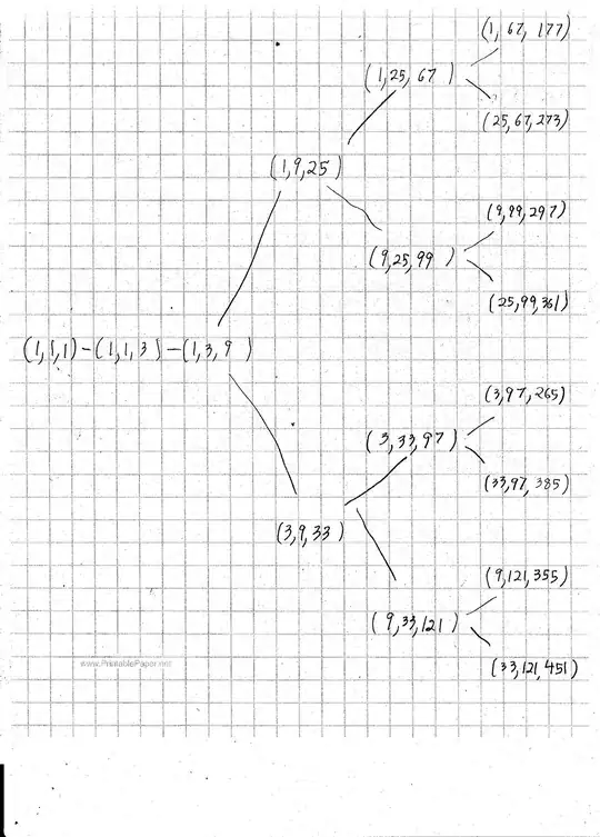

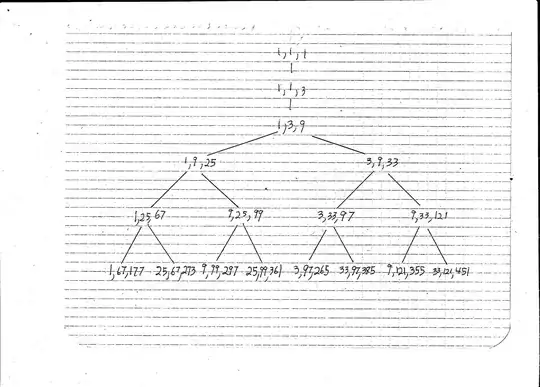

This gives exactly the sort of jumping that creates the Markov Tree Since the order of $x,y,z$ does not matter, it is traditional to order $1 \leq x \leq y \leq z$ to save space. Then, we get two jumps that go to the next bigger layer in the tree. The slower growth is ( I am ordering the outcome as well) $$ (x,y,z) \mapsto (x,z, 3x+3z - y - 2). $$ The faster growth is $$ (x,y,z) \mapsto (y,z, 3y+3z - x - 2). $$ This diagram is closer to the view in the wikipedia article
The first few layers are
How do we find the relevant formulas for the next two leaves, coming out of an existing leaf $(x,y,z)?$ This part is called Vieta Jumping. We have an (positive) integer solution to $$ x^2 + (2 - 3y - 3z)x + \; \mbox{stuff} = 0. $$ If the $x$ value we have and the other solution to the quadratic is called $x',$ we have $$ x + x' = 3y + 3z - 2, $$ so that $$ x' = 3y+3z-x-2, $$ in ascending order we get $(y,z,x').$
If we are going to flip the $y $ value instead, we have $$ y^2 + (2 - 3x - 3z)y + \; \mbox{stuff} = 0. $$ If the $y$ value we have and the other solution to the quadratic is called $y',$ we have $$ y + y' = 3x + 3z - 2, $$ so that $$ y' = 3x+3z-y-2, $$ in ascending order we get $(x,z,y').$
The best discussion of this that I know is a 1907 article by Hurwitz in German. In preparing my article in this field with Kaplansky, I relied on Cusick, Thomas; Flahive, Mari (1989). The Markoff and Lagrange spectra.
