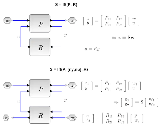

A $H_{\infty}$ controller look like the block diagram above. In this case $K = R$.
