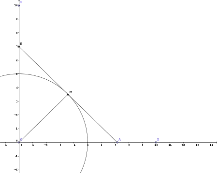

Line-segment AB has a fixed length of 10 units. point A moves on the positive x-axis and point B moves on the positive y-axis.
Point M is in the middle of line AB.
All right, I have been able to figure out the first question of the assignment: that M always stays on a circle from the Origin with a radius of 5.
However, the second question asks me to prove my answer from the first question.
How do I prove that M will always stay on this circle?

Let $M(h,k), A(a,0)$ and $B(0,b)$
So, using Pythagoras Theorem, $a^2+b^2=10^2$
As $M$ is the midpoint, $$h=\frac{a+0}2,k=\frac{0+b}2\implies a=2h,b=2k$$
So, $(2h)^2+(2k)^2=10^2\implies h^2+k^2=5^2$
So, the locus of $M(h,k)$ is $x^2+y^2=25$ which is evidently a circle centred at the origin with radius $5$ unit.
To prove that $M$ always stays on the circle with center $O$, and radius 5, you have to prove that $OM = 5$, no matter where $A, B$ are.
There is a theorem on right triangle, saying that: "The median on the hypotenuse of a right triangle equals one-half the hypotenuse", and remember that $AB = 10$, can you prove $OM = 5$?
