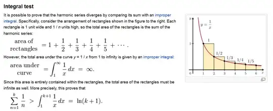

It looked similar to the harmonic series, so I checked wikipedia for Harmonic series, and found the following info.
So I was just wondering whether it could be simplified to $\log(i)$. Please help me solve it.

Concerning the finite sum you considered : $$\sum_{n=1}^k \frac 1n >\int_1^{k+1}\frac {dx}{\ln(x)}=\ln(k+1)$$ it provides in fact a proof that the harmonic sum grows without bounds (remember that you want the limit as $k\to \infty$ i.e. $+\infty$ here).
You may modify this (for example using $\left|\frac 1{i-n}\right|>\frac 1n$) to prove that your sum is divergent but won't get a bounded value like $\ln(i)$.
