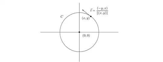

Given any point $(x, y)$ in the plane, let $C$ be the circle about the origin passing thru $(x,y)$, and observe that the unit vector $\vec t\ $ tangent to $C$ at $(x,y)$ is given by
If we project $F(x,y)$ onto this vector (notice that these vectors are parallel, although in the more general situation we are about to consider they might not be), we get the component of $F(x,y)$ that is causing a rotation around the origin, which is then given by $$ \langle F(x,y),\vec t\ \rangle = \left\langle (-\omega y,\omega x), \frac{(-y, x)}{\|(x, y)\|} \right\rangle = \frac{\omega (y^2+x^2)}{\|(x, y)\|} = \omega \|(x, y)\|. $$ Consequently we may estimate the value of $\omega $ in terms of the vector field at any point $(x,y)$ by the simple formula $$ \omega = \frac{\langle F(x,y),\vec t\ \rangle }{\|(x, y)\|}. \tag 1 $$

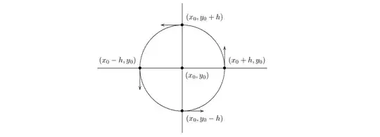

To account for this, let us choose many points, rather than just one, and average the outcomes of (2) for these points. A reasonable choice would be four points, to the right, to the left, above and below the point $(x_0,y_0)$ under consideration.
Fixing a parameter $h>0$, let us then consider the following four points $$ \matrix{ (x_1, y_1) &=& (x_0+h, y_0) & \quad \text{(right)} \cr (x_2, y_2) &=& (x_0-h, y_0) & \quad \text{(left)} \cr (x_3, y_3) &=& (x_0, y_0+h) & \quad \text{(above)} \cr (x_4, y_4) &=& (x_0, y_0-h) & \quad \text{(below)} } $$
Regarding $(x_1, y_1)$, for example, we would have $$ \vec t = (0, 1), $$ so $$ \omega _1 = \frac{\langle F(x_0+h,y_0),(0, 1)\rangle }{\|(h, 0)\|} = \frac{Q(x_0+h,y_0)}h. $$ Averaging the four angular velocity estimates $\omega _1$, $\omega _2$, $\omega _3$, and $\omega _4$, we get $$ \frac {\omega _1+ \omega _2 +\omega _3 + \omega _4}4 = \frac { Q(x_0+h,y_0) - Q(x_0-h,y_0) - P(x_0,y_0+h) - P(x_0,y_0-h)}{4h}. $$ In order to compute the infinitesimal angular velocity at $(x_0,y_0)$ we take the limit as $h\to 0$, which we may compute using L'Hopital rule, leading up to $$ \lim_{h\to 0_+} \frac {\omega _1+ \omega _2 +\omega _3 + \omega _4}4 = \frac 1 4 \left(\frac {\partial Q}{\partial x}(x_0,y_0) + \frac {\partial Q}{\partial x}(x_0,y_0) - \frac {\partial P}{\partial y}(x_0,y_0) - \frac {\partial P}{\partial y}(x_0,y_0)\right) = $$$$ = \frac 1 2 \left(\frac {\partial Q}{\partial x}(x_0,y_0) - \frac {\partial P}{\partial y}(x_0,y_0)\right) = \frac 1 2 \text{ curl }F(x_0,y_0). $$
