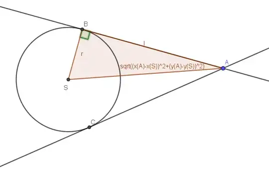

Suppose $f(x, y) =0$ represents a conic section, then $\sqrt{f(a, b)} =\sqrt{S_{11}} $ is the length of tangents drawn to conic drawn from point $(a, b) $
This can be easily done for circle but after that I have no idea where this is coming from and it's giving me an headache. It's given in my textbook without proof.

  • If $f(x,y)=0$ represents a conic section, then $kf=0$ does also for any number $k$. 2. The two tangents have the same length segments to the points of intersection with a circle, this is not the case anymore for a general conic section. For $f=x^2-xy+y^2-1$ and tangents through $(-2,0)$ the segments are $\sqrt{2}$ and $\sqrt{5}$ and $\sqrt{f(-2,0)}=\sqrt{3}$.
  • – Jan-Magnus Økland Aug 12 '17 at 14:22
  • @Jan-Magnus Økland A late comment : what really makes no sense is that $f(x,y)$ is defined up to a multiplicative constant... – Jean Marie Feb 10 '23 at 21:44
