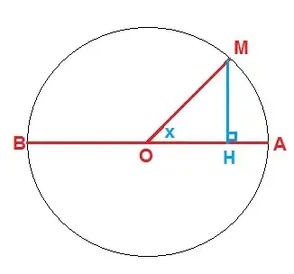

I found a geometric method to show $$\text{when}\; x\to 0 \space , \space \cos x\sim 1-\frac{x^2}{2}$$ like below :
Suppose $R_{circle}=1 \to \overline{AB} =2$ in $\Delta AMB$ we have $$\overline{AM}^2=\overline{AB}\cdot\overline{AH} \tag{*}$$and $$\overline{AH}=\overline{OA}-\overline{OH}=1-\cos x$$ when $x$ is very small
w.r.t. * we can conclude $$x^2 \approx 2(1-\cos x) \\\to \cos x \sim 1- \frac{x^2}{2}$$ Now I have two question :
$\bf{1}:$ Is there other idea(s) to prove (except Taylor series) $x\to 0 , \space \cos x\sim 1-\frac{x^2}{2}\\$
$\bf{2}:$ How can show $\sin x \sim x- \frac{x^3}{6}$ with a geometric concept ?

  • It's much more difficult, because $x$ is, in theory, a length of a curve, so $x-\sin x$ is comparing the arc MA to the length $MH$. – Thomas Andrews Aug 10 '17 at 20:07

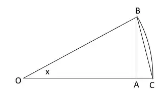

In this trigonometric circle we can compute $BC$ in two ways:
First, considering the $ABC$ triangle:
$$BC= \sqrt{AB^2+AC^2}=\sqrt{\sin^2 x+\left(1-\sqrt{1-\sin^2 x}\right)^2}=\\= x+ax^2+\left(b+\frac18\right)x^3+O(x^4) \tag{2}$$ [*]
Second, bisecting the angle $x$:
$$BC = 2 \sin \frac{x}{2}=x+\frac{a}{2} x^2 + \frac{b}{4}x^3 + O(x^4)\tag{3}$$
Equating (2) and (3) we get $a=0$ and $b=-\frac{1}{6}$, that is: $\sin x = x - \frac16 x^3 + O(x^4)$

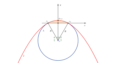

This answer uses another approach. We can approximate the area of a circular segment to an area of a parable. See the picture below.
ParableCircleApp
The area of a circular segment can be calculated by: $$A=\frac{R^2}{2}(\theta-\sin(\theta)) \tag{1}$$
The area of a parable between its zeroes $x_1$ and $x_2$ can be calculated by: $$A=\frac{2}{3}(x_2-x_1)y_{max} \tag{2}$$ where $y_{max}$ is the maximum ordinate of the parable.
If we use: $$x_2 =\sin(\frac{\theta}{2}) \tag{3}$$ $$x_1 =-\sin(\frac{\theta}{2}) \tag{4}$$ $$y_{max}=1-\cos(\frac{\theta}{2})= 2 (\sin(\frac{\theta}{4}))^2 \tag{5}$$ $$\sin(\frac{\theta}{2}) \sim \frac{\theta}{2} \tag{6}$$ $$\sin(\frac{\theta}{4}) \sim \frac{\theta}{4} \tag{7}$$ and $$R=1 \tag{8}$$ in equations (1) and (2) and after that we make the approximation that (1) and (2) are the same, we get: $$\sin(\theta) \sim \theta - \frac{\theta^3}{6}.$$

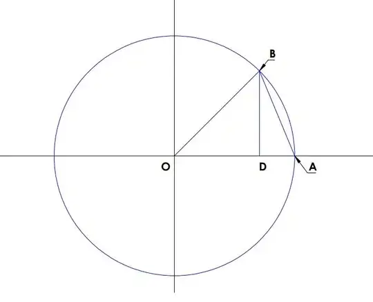

Not a complete answer, I am afraid. Approximating the arc $AB$ as a line segment leads to the correct approximation of $\cos(x) \sim 1 - \frac{x^2}{2}$ but leads to the inaccurate result for the corresponding sine as $ \sin(x) \sim x - \frac{x^3}{8}$. Nevertheless, I post my approach, since it has not been covered in the preceding answers.
In the above diagram, we have $OA=OB=1$ and $\angle BOA = x$
Let the co-ordinates of point $B$ be $(h,k)$
Since $B$ lies on the unit circle, $$h^2 + k^2 =1\tag{1}$$ The equation of the line $AB$ is given as $y^*=m(x^*-1)$ and since B lies on the line $AB$, we have $$ k=m(h-1\tag{2})$$ where $m$ is the slope of $AB$.
From $(1)$ and $(2)$, we have $$\Rightarrow h^2 + m^2(h-1)^2=1 $$ $$\Rightarrow h^2(1+m^2) - h(2m^2) + (m^2 -1)=0 $$ which gives two values of $h$, of which one value $h=1$ is for the point $A$ $$\Rightarrow h=\frac{m^2 -1}{m^2 +1}, \; k =\frac{-2m}{m^2 +1} \tag{3}$$
The length of the line segment $AB$ is assumed to be $x$, hence $$\Rightarrow (h-1)^2 + k^2 =x^2 \tag{4}$$
Using $(2)$ and $(4)$, we get $$ \Rightarrow (1+m^2)(h-1)^2 =x^2$$ $$\Rightarrow x=|h-1|\sqrt{1+m^2}=(1-h)\sqrt{1+m^2}$$ From $(3)$, we have $$ \Rightarrow x=\frac{2}{\sqrt{1+m^2}}$$ $$ \Rightarrow 1+m^2 = \frac{4}{x^2}$$ $$ \Rightarrow m = \sqrt{\frac{4-x^2}{x^2}} \tag{5}$$
Now, using $(5)$ and $(3)$, $$ h=OD=\frac{4-2x^2}{4}, \; k=DB= \frac{x\sqrt{4-x^2}}{2}$$
Thus $OD = \cos(x) \sim 1-\frac{x^2}{2}$ and $DB= \sin(x) \sim x(1-\frac{x^2}{4})^{1/2}$
This gives $\sin(x) \sim x - \frac{x^3}{8}$, which isn't quite correct.
