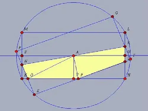

There is this rectangle with sides $a<b$. The rectangle is bent along a line that passes through the center of the rectangle. At which angle $\alpha$ (i. e., angle $\angle RAU$ – see the picture) should we bend the rectangle in order to get the minimum area of crossing intersection?
It is obvious that if $|a-b| \gg 0$, then $\alpha\approx\pi/4$. Also, we can look at the pentagon NOPQR. In addition to that, for a certain $a/b$ we get the triangle ($a/b<0.8150237, \alpha =\pi/4$).
All in all, I am looking for a graph: $a/b$ as in terms of $\alpha$ and the area of the crossing intersection, which is $\displaystyle S = [2ab - (a^2+b^2)t + 2abt^2 - (a^2+b^2)t^3]/[4(1-t^2)]$, where $t=\tan \alpha$.

  • I assume alpha is the angle that the line through the center makes with one of the sides. Which side? – Matthew Conroy Feb 25 '11 at 19:14
  • The rectangle is bent along the line which goes through the diagonal crossing under alpha angle. ( I have a picture, but cannot upload it) – Mikhail G Feb 25 '11 at 19:29

  • It looks like the optimal $\alpha$ is given by the roots of $t^4-4 t^2 + 8 [ab/(a^2+b^2)] t -1$. So how would you proceed without Ferrari? By the way the discriminant of this equation is zero for $a/b = \sqrt{29 - 6 \sqrt{6}} \approx 0.76$ which doesn't seem to agree with 0.81 you mentioned in the question... (I'm however not sure if it should) – Fabian Feb 26 '11 at 21:25
  • Look, S'=-(a^2+b^2)+8abt-4(a^2+b^2)t^2+(a^2+b^2)t^4=0. Let a/b=\tg \beta, then k=\sin 2\beta=2ab/(a^2+b^2), so t^4-4t^2+4kt-1=0, then imagine graphics: f=t^4-4t^2-1 and g=-4kt. Guess different k. Also, f=g, f'=g'--> C=k_0>5/(3\sqrt3), t_0=1/\sqrt3. C=2x/(1+x^2)--> T=(3\sqrt3-\sqrt2)/5 You should not use Ferrari to understand the general idea how to bend. But the critical area is very confusing to me – Mikhail G Feb 26 '11 at 21:51
  • $k=5/(3\sqrt3)$ corresponds to the critical value $a/b = \sqrt{29- 6 \sqrt{6}}/5$ where the discriminant is equal zero (I forgot the $1/5$ in the last comment), so we agree there. It seem that you have the solution. What exactly is the question and what is confusing about the critical area? – Fabian Feb 26 '11 at 23:06
  • Dilemma, when a/b is close to 1. kchanges from 1 to C--> the first root of the mentioned polinom ( do not miss the second root t_2>t1 and we need t_1) changes from \sqrt2-1 to 1/\ sqrt, that is t(T(k) is monotonic-> inversion function:k=(1+4t^2-t^2)/(4t). Let s=\tg \beta=a/b & u=b/a->s(k), u(k) --> S(t,a). Find u(t) and finally get S(t,a) - the minumum area of the pentagon to compare with a^2/2 Here you need to do numerical job. If you plot s(t) for (\sqrt2-1,1\sqrt3)&(0.3,0.9), you'll see it. So, there is t_0: t<t_0 we have S<a^2/2->t_0=0459133.., u=1.226958.. 1/u=a/b=0.8150237->\alpha=\pi/4 – Mikhail G Feb 27 '11 at 05:41
  • and \alpha=0.430423... That is confusing Right? Why C is not critical now? – Mikhail G Feb 27 '11 at 05:43
  • Yes, it looks like the pentagon has only minimal area for $0.81 \leq a/b$ afterward the triangle is more optimal. What is confusing now? (yes, $\alpha$ jumps but this can be) – Fabian Feb 27 '11 at 14:52
  • Thank you, but if $a/b <0.81$, the triangle will be the minimum area.Right? 1)Actually the pentagon and triangle have the minimal area for $0.81$, Right? 2)Also $t>t_0$, ie $a/b>0.81$ --> $\alpha=arctg(t_1)$. The jumping was a bit confusing – Mikhail G Feb 27 '11 at 17:17
  • Could you plot the final graph? – Mikhail G Feb 27 '11 at 17:26
  • I do not really know how to plot the graph. As far as I see it $\alpha = \pi/4$ for $a/b < 0.81$ and then it switches over to the solution of the quartic equation (at $a/b=0.81$ there are two solutions with equal area but different shape) -- so got it right. – Fabian Feb 27 '11 at 23:18
    Agree, $a/b \approx 0.81$ there are two shapes in the crossing intersaction. Have you ever thought about the sizes of paper towels? Why do they have the particular sizes? I searched for eg German paper towels and found that $a/b>0.81$ (very close to $0.9$ or even $1$. So, do you think the manufacture can slightly reduce a/b with no changes in property of the current paper towels but adding a new one (while bending)? – Mikhail G Feb 28 '11 at 17:59
  • in over words $a/b \approx \sqrt{\frac {2} {3}}$ – Mikhail G Feb 28 '11 at 18:04

The minimum area occurs when $\alpha=\frac{\pi}{4}$ and it is equal to $S_\rm{min}=a^2/2$
Why? Well I solved this problem using a parametric CAD system and then using geometry. If the height of the towel is $a$ and the width is $b$ with $a<b$ then the critical aspect ratio is $\eta_c=\tan^{-1}\left(\frac{a}{b}\right)$. When the fold angle $\alpha\leq\eta_c$ then the common area is
$$ S_1 = \dfrac{2 a b\cos\alpha-(a^2+b^2)\cos\alpha}{4\cos\alpha (2\cos^2\alpha-1))} $$
but when the fold angle is $\alpha > \eta_c$ then the area is
$$ S_2 = \dfrac{a^2}{4\cos\alpha\sin\alpha} $$
which has a minimum at $\alpha=\pi/4$. The key to the solution is finding the coordinates of the point where the two long sides of the towel intersect after the fold (point $P$ above). This calculates to: $P=(\frac{a}{2}\tan\alpha,\,-\frac{a}{2})$ in a coordinate system in the middle of the towel.
In the end I take the area of half a tower and subtract the triangular parts that stick out. The math I used are based on homogeneous coordinates for the lines, such that a line $L=[A,B,C]$ has an equation equal to $[A,B,C]\cdot[x,y,1]=0$ or $Ax+By+C=0$.
Two points $P$ and $Q$ join with the line $$\rm{JOIN}(P,Q)=\left[P_2-Q_2,Q_1-P_1,P_1 Q_2-P_2 Q_1\right]$$ where $P=(P_1,P_2)=(x_P,y_P)$ and the similarly for $Q$.
Then two lines $L$, $K$ intersect at $$\rm{MEET}(L,K)=\left[\dfrac{L_2 K_3-K_2 L_3}{L_1 K_2 - L_2 K_1}, \dfrac{K_1 L_3 - L_1 K_3}{L_1 K_2 - L_2 K_1}\right]$$ where $L_1$, $L_2$ and $L_3$ are the components of line $L$ and similarly for $K$.
The area of a triangle with vertexes $A$, $B$ and $C$ is
$$ \rm{AREA}(A,B,C) = \frac{1}{2}\left( (B_1-A_1)(C_2-A_2)-(C_1-A_1)(B_2-A_2) \right)$$ that comes from the derivation of the cross product of the vectors $B-A$ and $C-A$.
In addition, the following is true:
  1. The folding line has coordinates $L=[-\sin\alpha,\cos\alpha,0]$.
  2. Point $E$ has coordinates $E=(-\frac{b}{2}\cos2\alpha+\frac{a}{2}\sin2\alpha,\,-\frac{b}{2}\sin2\alpha-\frac{a}{2}\cos2\alpha)$
  3. Point $T$ has coordinates $T=(\frac{b}{2}\cos2\alpha+\frac{a}{2}\sin2\alpha,\,\frac{b}{2}\sin2\alpha-\frac{a}{2}\cos2\alpha)$
