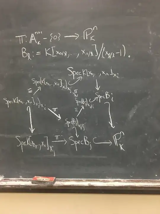

I understand why this works on a very technical level, essentially it seems to be because this diagram commutes (which is mostly because a map of affine schemes is given by its map of global sections):

The problem is that $X$ is a non-affine scheme, and to construct a map you must define it locally and prove it glues to a global map. If $U:=Spec(B), V:=Spec(A)$ it follows
$$F1.\text{ }Hom_{Sch}(U,V) \cong Hom_{rings}(A,B).$$
Hence for affine schemes you define a map $\phi: U \rightarrow V$ via a map $f: A\rightarrow B$. Since $X$ above is non-affine you use formula $F1$ locally and define maps locally. To get a well defined global map of schemes you must prove that these locally defined maps glue (agree on intersections). It seems to me this is what is "explained" on the photo, but there are no explicit formulas. Above I give such formulas for the projective line.
