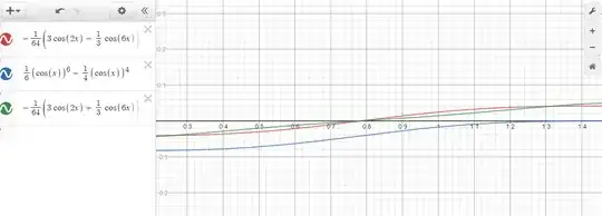

P.S. The answer you got is wrong. See this. here Note that red curve and blue curve are the answer you could get. But you got green curve, which is wrong. Also note that red curve and blue curve same but red curve slide upward a little (constant difference!).

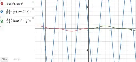

Look at the following graph: enter image description here
We want the derivative of both the functions you have given to line up with the red graph. As you can see from this image, only the green graph (the $1/6$) one does. I made it so that it only displays values $x>0$ so you can actually see that if it wasn't that, then it would completely overlap.
So your book is right. As for your solution, I can't tell. Please show the steps you took in your solution. I just know that your solution is wrong.
