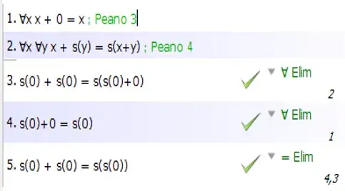

And yes, $1+1=2$ could be a logical consequence of some axioms involving numbers. In fact, we could just have $1+1=2$ as an axiom. But we can also infer it from more basic principles, e.g. the Peano axioms. Now, actually, the typical Peano axioms don't immediately work, since they only use $0$ and the successor function $s$. However, we could say that we use $1$ as short-hand for the expression $s(0)$, and $2$ for $s(s(0))$, and now you can prove '1+1=2' as an arithmetical truth that logically follows from the Peano Axioms:

But in the end, all this proof shows is that $1+1=2$ is an arithmetical/mathematical truth, or an arithmetical/mathematical theorem: something that can be proven on the basis of certain assumptions/definitions made in the domain of arithmetic/mathematics. But it is not a truth on the basis of purely logical principles, and so it is not a logical truth.
