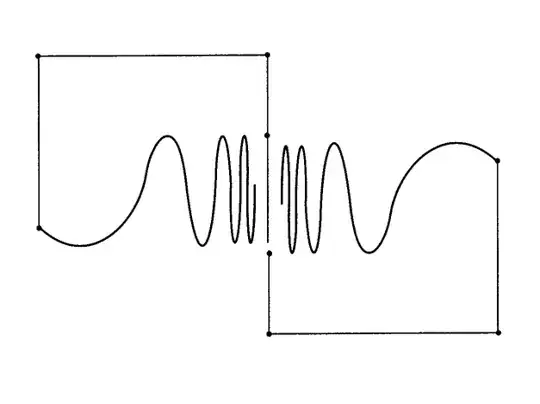

For example, consider a figure-8 type curve such that the ends approach the middle of the figure 8 from both sides like a topologists sine curve pictured below (this picture is edited from a picture in Munkres Topology, 2ed, p381, or the examples discussed in this answer: Is there a continuous injective map from $\mathbb{R}$ that has compact image?). The complement of the image of this curve has three components.
