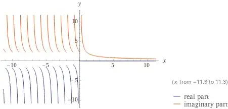

Plot for $\left( -1 \right)^{1.5} = i$:
"Plot[i Gamma[1.5] HurwitzZeta[1.5, x], {x, -10, 10}]" by Wolfram|Alpha

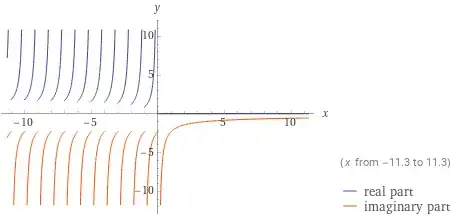

Plot for $\left( -1 \right)^{1.5} = -i$:
"Plot[-(i Gamma[1.5] HurwitzZeta[1.5, x]), {x, -10, 10}]" by Wolfram|Alpha

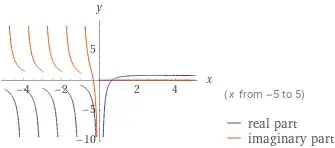

A plot of this definition would look like this:
Plot of Polygamma[0.5, x] by Wolfram|Alpha
