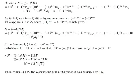

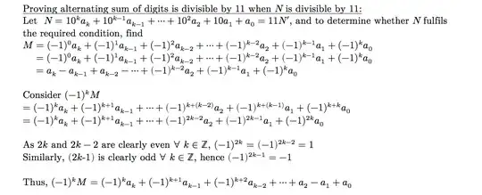

So I actually need 2 proofs for (1) if alternating sum is divisible by 11, then N is divisible by 11; and (2) if N is divisible by 11, then alternating sum is divisible by 11.
My teacher did the following and although it works, it also seems unnecessary at times and extremely long.
My questions are:
(1) is there a less convoluted way to prove the above?
(2) similarly, how do I prove N is divisible by 11 when the alternating sum of its digits is divisible by 11?
