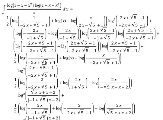

I was doing experiments with Wolfram Alpha online calculator, about similar integrals (simpler than the below one) and wondered about how get a closed-form for $$\int_0^1\frac{\log(1-x+x^2)\log(1+x-x^2)}{x}dx\tag{1}.$$
I've calculated the definite integral using the online calculator, but I believe that the output is an approximation, and since after of this, I've asked to Wolfram Alpha about the indefinite integral, I know that Wolfram Alpha can calculate it, but to me is impossible to evaluate the terms (are about two pages)
int log(1-x+x^2)log(1+x-x^2)/x dx
Question. Is there some way to evaluate this integral in $(1)$? This was just a curiosity, but I am asking here if you know such integral or do you know how get the evaluation of our integral. Thanks in advance.
Since Wolfram Alpha's answer seems to me difficult, I didn't any attempt (change or variable, integration by parts...).

  • The bottom of the formula for the antiderivative seems to have been cut off. – Robert Israel Jul 07 '17 at 20:45
    Presumably there must be terms involving $x - (1 \pm i \sqrt{3})/2$, which are the factors of $x^2 - x + 1$. – Robert Israel Jul 07 '17 at 20:47
    The integrand at the top is slightly different from the OP's (it has $\log(1-x\color{red}-x^2)$ instead of $\log(1-x\color{blue}+x^2)$), but I don't imagine the answer would be much simpler. – Antonio DJC Jul 08 '17 at 05:32
