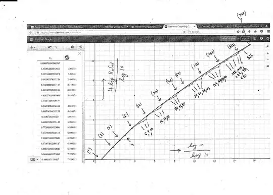

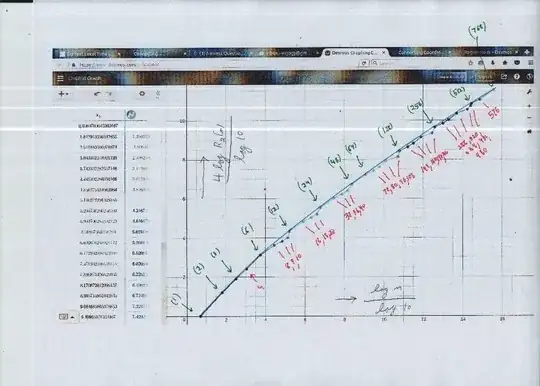

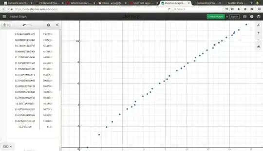

There is a procedure initiated by Ramanujan that can be applied to this problem. With the same definitions as those for Superior Highly Composite Numbers, here are the first few numbers that are "superior" in the count as the sum of two squares, where the numbers being squared are positive and in order.
The nature of the construction is that these numbers are quick to create, while each is guaranteed to have more representations (as the sum of two squares) than any smaller number.
Well, why not. We fix a real number $\delta > 0.$ For each prime $p \equiv 1 \pmod 4,$ we take the exponent $k$ of $p$ as $$ k = \left\lfloor \frac{1}{p^\delta - 1} \right\rfloor $$ If $p > 2^{1/\delta},$ then the denominator above exceeds $1$ and the relevant exponent is actually zero. That is, the product is actually a finite product.
Meanwhile, we are able to invert this in closed form. The first (largest) $\delta$ for which prime $p$ is given exponent $k$ is $$ \delta = \frac{\log \left( 1 + \frac{1}{k} \right)}{ \log p} $$
As in the srvey article by Nicolas, in a log-log graph of $\log n$ and $\log r_2(n),$ these "superior" values, in output below, show up as the vertices of the convex hull of the (infinite) graph. Note that I told it to multiply the vertical component by 4, to create a little vertical separation between nearby points. I will need to experiment to draw in the line segments, I may need to do that by hand. You can see, though, how some points in the plot below are higher compared with those nearby... Alright, added line segments and labels by hand
enter image description here enter image description here enter image description here
