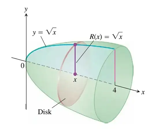

The volume of the object in the above picture is given by, $$V=\int_{0}^{4} \pi y^2dx$$

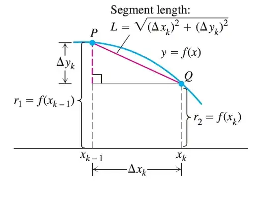

While dealing with calculating surface areas of objects, I was introduced to the integral, $$S=\int_{0}^{4} 2\pi y\sqrt{1+(y')^2} dx$$ where $\sqrt{1+(y')^2} dx$ is the infinitesimal arc length.
Is it reasonable to improve the definition of the volume of a solid object to be $V=\int_{0}^{4} \pi y^2\sqrt{1+(y')^2} dx$?
Geometrically, the segment length is a better approximation. However, when the interval tends to zero, the arc, segment and $\Delta x$ tend to coincide. So, as the interval goes to zero, I can consider the infinitesimal segment length instead of $dx$, can I not?
What I would like to know is if $V=\int_{0}^{4} \pi y^2\sqrt{1+(y')^2} dx$ is valid or not. If not, then why?

  • Compute the volume of the circular cylinder obtained by rotating the line $y=1$ around the $x$ axis and bounded by $x=0$ and $x=1$. Then compute the volume of the union of the same cylinder but bounded by $x=1/n$ and $x=1$ with the cone generated by revolving $y=nx$ around the $x$ axis and bounded between $x=0$ and $x=1/n$. Take the limit as $n\to\infty$. – Bettybel Jul 06 '17 at 13:09
  • The volume of the shown paraboloid is not $\int_{0}^{4}\pi y^2,dy$ but $$ V=\int_{0}^{4} \pi x,dx = \color{red}{8\pi}$$ since the section $x=k$, for any $k\in[0,4]$, is a circle having area $\pi x$. – Jack D'Aurizio Jul 06 '17 at 14:34
  • The surface area is given by $$ \int_{0}^{4}2\pi g(x)\sqrt{1+g'(x)^2},dx $$ where $g(x)=\sqrt{x}$ (see here: http://tutorial.math.lamar.edu/Classes/CalcII/SurfaceArea.aspx) hence $$ S = \int_{0}^{4}2\pi \sqrt{x+\frac{1}{4}},dx =\color{red}{\frac{\pi}{6}\left(17\sqrt{17}-1\right)}.$$ – Jack D'Aurizio Jul 06 '17 at 14:38

  • The geometry seems to confuse me. The segment length appears to be a better approximation than $\Delta x$. As the interval falls to zero, the segment length and $\Delta x$ fall on each other. The difference in lengths becomes insignificant. However, replacing $dx$ with the infinitesimal segment length does not yield the right result. The geometry suggests whereas the math does not. – R004 Jul 07 '17 at 02:27
  • Oh! Wait a minute. I realized where I went wrong. My integrand was a product of the slant height of a frustum and the area of a circle. This is wrong because the volume of a cylinder is not the mentioned product. Ah! Silly mistake. – R004 Jul 07 '17 at 03:23
  • This brings me to another question. Can I calculate the volume of a solid by integrating infinitesimal frustum volumes? The reason why I asked this is because in wiggly, non-cylindrical solids, a frustum is a better approximation than a cylinder. Well, as $\Delta x$ goes to zero, the frustum and the cylinder become identical. I'm not sure if integrating frustum volumes will give us better results. But I am sure that the process will become complicated. – R004 Jul 07 '17 at 03:29

It is reasonable to improve the definition of the volume of a solid object that can be defined to be
$$V=\int_{0}^{4} \pi y^2 dx$$
by assembly of infinitesimally thin disks shown, so that the direction of building up of volume is strictly perpendicular to the base circle plane.
