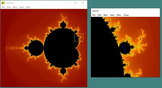

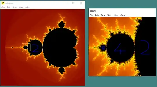

  1. Is it the case that the largest bulb off any bulb has a periodicity that is double the periodicity of its parent bulb. For instance, see:
Mandelbrot set (left) with zoomed in area (right), periods of bulbs written on in blue
All bulbs that I've tried this with, this seems to be the case. Any proof or reason would be welcome.

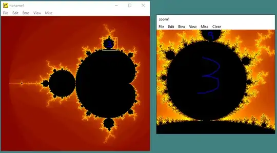

  1. It appears that the second largest bulb has a periodicity that is triple that of its parent bulb - see below.

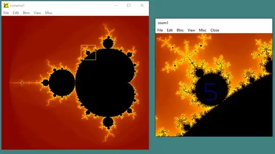

Similarly, I had conjectured that for any n, the nth largest bulb has a periodicity that is n+1 times larger than its parent bulb. (this is not counting the negative unreal half of the Mandelbrot set, as it is a symmetrical to the positive unreal half) However, I soon realised that there were two different period 5 bulbs off the main cardioid, of different sizes:
Similarly, there were two bulbs of period 10 off the '2' bulb, and two bulbs of period 15 off the '3' bulb. Any thoughts? What makes a number, like 5, get more bulbs of different sizes?

Mu-ency's enumeration of features page states:
There is one secondary continental mu-atom for each rational number between 0 and 1. The secondary continental mu-atoms of period n correspond to the rational numbers with n in the denominator. Because of this, the number of secondary continental mu-atoms is equal to Euler's Totient function:
$$\phi(n) = n - \sum_{f:\gcd(n,f)=1}1$$
That is, take n and subtract 1 for every number that is relatively prime to n. This sequence is Sloane's sequence A0010. It starts:
0, 1, 2, 2, 4, 2, 6, 4, 6, 4, 10, 4, 12, 6, 8, 8, 16, 6, 18, 8, 12, 10, 22, 8, 20, 12, 18, 12, 28, 8, 30, ...
Because of period scaling, each mu-atom has children that have the same distribution as the secondary continental mu-atoms, but with scaled-up periods. [...]
