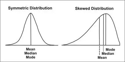

He later pointed out that the centre of mass does not necessarily divide a distribution into two. Looking at the one-dimensional case,
mean vs median
I should have used the median instead of the mean. Is there an equivalent "median of mass"?

  • I should say that dividing along the proper principle axis will help in a symmetric cut. But also remember that COM is slightly different from mean as it's a mass weighted average, for a 2D shaped graph like the ones illustrated the COM and mean won't necessarily lie in the same spot – Triatticus Jul 04 '17 at 19:09
  • Exactly, that's why I thought I should have used the median instead of mean. But what is the equivalent of median for 3D shapes? – Gnubie Jul 04 '17 at 19:13
  • I'm actually not entirely sure – Triatticus Jul 04 '17 at 19:19
